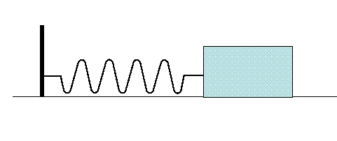

The position of the center of the box shown is given by the equation:
x = 4.4 m * cos(29/sec * t)
(a) What is the position of the box 2 seconds after the oscillations have started?
x = m
I don't know how to start A. I plugged in 2 seconds for t in the above equation, but my answer is not right.

Is there anything special about "the box shown"? I am imagining a box attached to a device that makes it oscillate according to the described function. Does it start at x=0? EDIT: when t=0 where is the box?
I attached the picture. Can you see it? Its supposed to be an attachement.

You might consider that 29*t/sec yields radians. No conversion required. What's 4.4m x cos(29 x 2 radians) ?
I got 2.331644763, which is also not correct.
That would be the result for 2*29 DEGREES. Try 2*29 RADIANS. Is your calculator set to degrees mode?
So per equation, someone pulls the box out to the right to a 4.4m hash mark then let's go at t=0.
If 29 is in Hz, the result should be 4.4m
If 29 is in rad/sec, the result should be 0.52m (I don't think you checked this)
