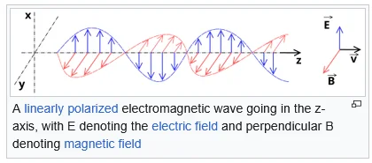

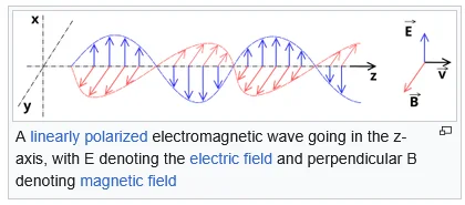

Light waves have E and B components. The oscillating E-field component is what accelerates electrons in antennas and other metal structures that the EM wave passes through/around. Does that sound familiar?
https://en.wikipedia.org/wiki/Electromagnetic_radiation
Diagram of a linearly polarized electromagnetic wave travelling along the z-axis, with blue arrows showing the electric field E and red arrows showing the perpendicular magnetic field B, plus x, y, z axes and E, V, B direction labels.
