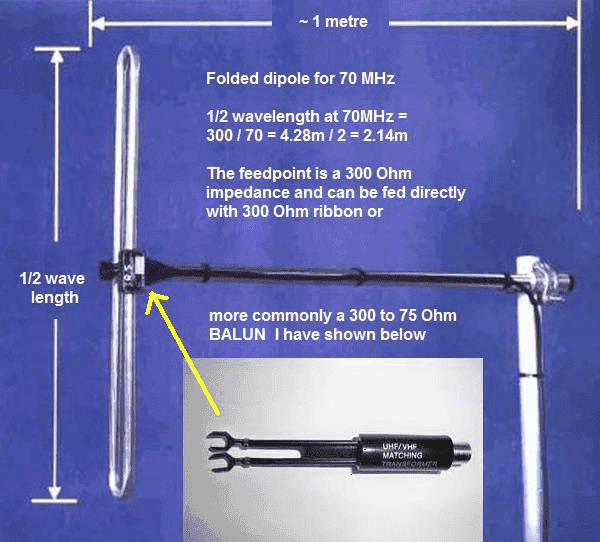

What i need are the ff:
  • basic guidelines on how to create an outdoor antenna (you can send links :))
  • the most suitable type of antenna that can receive 70 MHz tv station frequency. The antenna will be mounted less that 3 m from the ground.
  • computations that i need to know (you can also send links)
i know i could just search the net but i basically have a little knowledge about antennas so i don't quite understand what i searched if its right or what :( you know that feeling haha

you have given no indication of gain required, how far you are from the TV transmitter etc
a basic folded dipole and balun ( buy the BALUN) I have annotated a pic below
this is a vertical polarised dipole, you will need to see what is used locally, look at your neighbours antennas
That's very inefficient ... yes, it will work but not well ... height is everything !if you don't think you could engineer an antenna, just buy one, they are not overly expensive

thank you for responding! Is there a way where i can combine the folded dipole antenna with another kind of antenna (except yagi-uda) so that i can make the antenna more efficient. (And if there's a way where i can make the antenna efficient with that height :( )

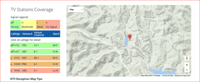

Seems to me first thing you need is an estimate of signal strength where you are.
Oh No ---
FCC has moved their map page from what i linked in my Yagi thread
to here
https://www.fcc.gov/media/engineering/dtvmaps
Whew i thought it was gone !
here's what it shows for my next door neighbor's house. He gets far better signal than i do..
clicking on a station tells you estimated signal strength . That'll tell you how exotic an antenna you need. And it gives compass heading to the transmitter to help you aim it .
If you're only interested in 70 mhz tune an antenna for it. That's what i did with my Yagis, i needed them being so far down in a valley in a fringe area anyway.
you can zoom in right to the spot in your yard where you plan to put the antenna.
