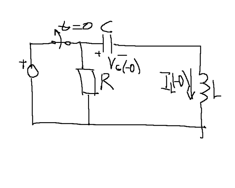

When we have a damped system,we have 3 types of responses of the system,what really determines how our system will behave?
\alpha = R/2L
\Omega = 1/LC
Overdamped system solution is x(t)=A1*exp(\alpha+\sqrt(\alpha^2-\omega^2) + A2* exp-(\alpha+\sqrt(\alpha^2-\omega^2),this green exponential decay is when one of the constants is zero I guess,because then we have exp(-t),what about other curves?

Yes,I know that roots determine system behaviour,what I wonder is about DAMPED system,we have 3 variations of the response and I forgout to multiply by t

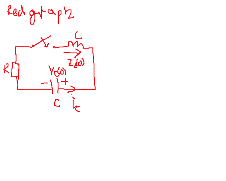

I am really sad that none actually understood my question,what I figured out,those 3 graphs are determined by initial conditions, for the blue one if the capacitor has initial voltage as on the picture it will produce a current that has the same direction as the initial current of the inductor,that's why we have a little 'spike' over value of 1.(they are being added up)
The red graph ,is when we have initial voltage on the capacitor producing a current in ic in the opposite direction of the initial current in the inductor ,and therefore we have a negative 'spike' ,because in the scenario of the blue graph currents add up,and here one current will have bigger value than the other one.
What about the green graph,I am not quite sure about it?

The middle graph is what would result when the capacitor has an initial voltage but there is no initial current in the inductor.
I think you might have the direction of initial IL around the wrong way for red and blue, but anyway your idea sounds spot on.
I'm not sure that the values of RC and L that give rise to the red curve would, without change, also be able to produce the blue and green curves, but a simulation would easily confirm this is so just by setting different values for IL(0).

IL(0-) cannot be anything but 0 (assuming the switch closes at t=0)
if it opens at t=0 that is a different story
Check your equation again.

Well man,I've made a mistake,I forgot to add a voltage/current source in the parallel,my background is very good at electronics,but this doesn't have to do anything with electronics,it's circuit theory.

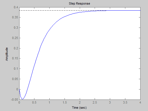

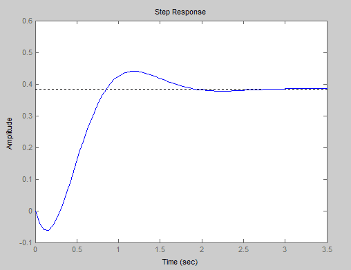

(-s+5)/(s^2+4*s+13)
look at the step response of the tf I posted
matlab code below
sys=tf([-1 5],[1 4 13])
step(sys)
step response above

I can switch to an overdamped system. it will not effect the initial shoot in the other direction
(-s+5)/(s^2+8*s+13)
