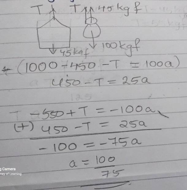

Here's my attempt to solve part b. I am not sure how to approach part a.
Please be kind to help me.
The answer of part be must be 2m/s² but I get a different answer.

Have you tried a FBD and summation of forces and moments for part a?

Your FBD is not right. You are forgetting forces and the signs don't look right. And there are no units. If you plug the numbers in you must also use the correct units.
I suggest you take up to be positive and write down the force equations for the man and the lift. Try to get those correct first.

Post #3 was in respect of part a, the question about an accelerating car.
The attempt attached in post #1 was for part b. The OP seems to have taken the acceleration as positive down. All your points are valid but the answer obtained looks ok.

The force equation for the lift omits the weight of the lift itself. The answer should be ##0.2g##, which is what I get and is the answer quoted by the OP.

Ahem... yes, I missed that.

I am so sorry, I have included it in the new solution.
Thanks a lot for your help! ☺
For the Crate:
$$T - 450N - 250N = 25a$$
For the Painter:
$$T+450N - 1000N = 100a$$
On solving I get, ##a =2m/s²##
##T = 75kgf##
I tried latex for the first time! It works!
