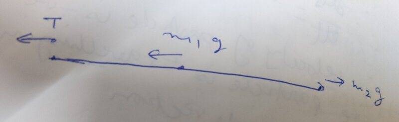

That's a nice trick that helps to solve problems on Atwood machine. But I was wondering if it has a wider applicability when considering masses connected via pulleys like on an incline or more complex cases of Atwood machine as shown in images below. If it could, then this would be an awesome trick in solving many difficult problems.
I tried to apply your straightening trick to first pulley masses system and came up with following straightened string.

vcsharp2003 said:
But I was looking only at the mass of putty since you metioned ##mV - mv## as change in momentum and surely the impact force on this mass will decrease its speed, which will decrease it's momentum. The change in momentum equation is only depending on initial and final momentum of putty, so I focused only on the mass of putty.
The putty’s change in momentum (mV – mv) is the same as the system’s change in momentum (because the net momentum of the buckets is always zero).

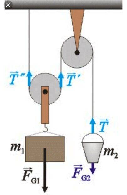

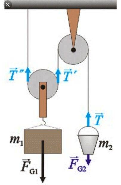

View attachment 300435View attachment 300430
Is your graphic solution referring to that image?
If so, you need to consider the effect of the moving pulley on the mechanical advantage or ratio of output force (FG1) to input force (FG2) in this system (mass 1 having half of the speed of mass 2).
