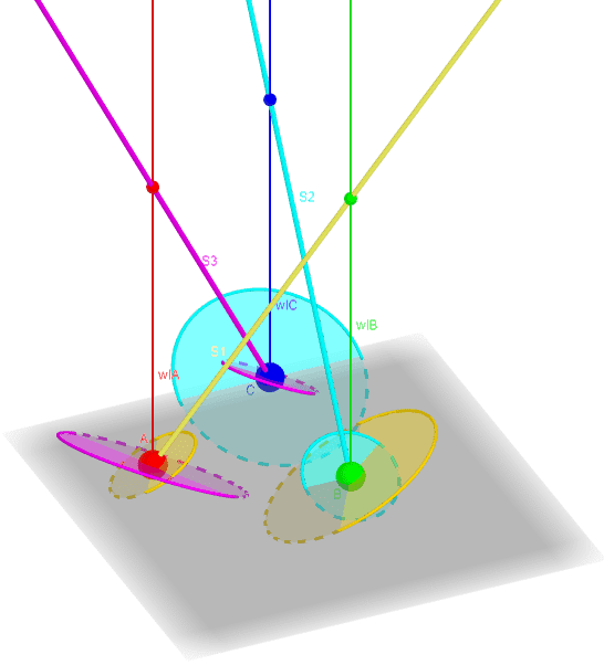

Here's a visualization. I think I rendered it correctly.
A,B,C with colors R,G,B
S1 from A to B (i.e. R to G) is Yellow, etc...
The smaller disk is has a larger t-component in that frame.
Of course, events A,B,C are acausally related.
So, there is no invariant causal ordering of these events.
(There is transitivity among a causally-related set of events, but not among an acausally-related set.
