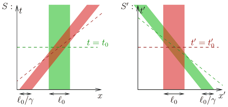

I would like to propose a relativistic problem that I cannot understand.
A car of rest length L travels at close to the speed of light towards a garage, of length L, which also has an opening at the bottom. For a person next to the garage door, the car has a length less than L, due to the contraction of lengths, so it is possible to close both garage doors at the same time with the car inside. According to the driver, however, it is the garage that has a length less than L, due to the contraction of lengths, and therefore it is impossible for the two doors to be closed at the same instant with the car inside the garage. Are the two conclusions contradictory? Can you provide an explanation?
The only explanation I can think of is that if you close the two doors at the same time in the system in which the car is moving, it means that you don't close them at the same time in the system of the car. Even if the car is longer than the garage, in the driver's system the back door of the garage closes late, and the car (or at least the half further back of the car, if the front has crashed) meanwhile keeps moving.
If the explanation of what happens in the system in which the car moves is correct, one can place a car at rest long L in a garage smaller than the car. It stands to reason that for this to be possible, the car must somehow get off the ground, at least when you try to stop it. But why should the two doors close non-simultaneously for the driver? And why should the front one close first and not the rear one first?
Thank you for any clarification.
Spot on. This is relativity of simultaneity in a nutshell.

Thank you very much. So this would be the explanation for this paradox? Isn't it a very specific paradox?

Both frames are correct. All frames will agree on physical things such as if the doors closed before/after the car passed. Where they do differ is in which events are simultaneous.
Only in that frame will the car be fully inside the garage. Unless it stops moving (which comes with its own problems) it will quickly crash (or exit the garage if you open the back door again.
That is simply how the relativity of simultaneity works between those two frames.

It is a pretty standard ”paradox”. I put it in quotations because it really only seems a paradox if you don’t understand the relativity of simultaneity.
”Fits in the garage” is a statement that refers so the entire car fitting at some given time, ie, simultaneous events of the car’s front and back are within the garage doors. Since what simultaneous means differs between frames, it is just natural that the fit or not conclusion may change between frames.

It’s a very common teaching example, often described using a barn or a tunnel instead of a garage, and a pole, ladder or train instead of a car - but the key idea is the two doors closing at the same time in one frame but not the other. Google for “pole-barn paradox” and “ladder paradox relativity” and you’ll get a ton of examples.
I find that the best way of understanding it is to draw a Minkowski spacetime diagram plotting the four relevant paths through spacetime: path of the front end of the car, path of the rear end of the car, path of the near door, path of the far door. Two of these will be vertical lines, two will be parallel and slanted. I’m not going to bother drawing/posting one because that Google search will find several bazillion already online. Some will even be here at PhysicsForums.

For those too lazy to google (from my lecture notes):
The sheets are the car (red) and garage (green) in their rest frames ##S'## and ##S## respectively. The dashed lines show the simultaneities for both frames.
In a typical Minkowski diagram, for all events on the t' axis is valid:
##x' = 0 ## and ##x=vt## (relativity of "same location", also known from Galilean relativity/intuition).
In a typical Minkowski diagram, for all events on the x' axis is valid:
##t' = 0 ## and ##t=\frac{v}{c^2}x## (relativity of "simultaneity", not known from Galilean relativity).
In Galilean relativity, the x' axis would be horizontally: ##t'=t =0## (absolute time).
