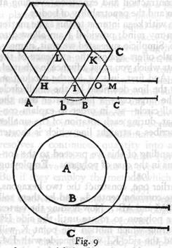

In road's IFR, let us see Fig.9 of Galilei's New Science.
AB, part of the hexagone periphery, is on the line C. Next the hexagone rotates around B and BC is on the line C, next the hexagone rotates around C, etc with constant pace. There is a moment that both A and B are on the line C in hexagone (I, approximately)FR. But for the line IFR "A is on C" and "B is on C" can not be simultaneous. "A is on C" is past of "B is on C". Distance between A,B marks on C is ##\gamma l_0## where ##l_0## is proper lenght of periphery AB. The result is similar for any n-polygone, circle in limit. Thus we know in N turn
[tex]2\pi R \gamma N = 2\pi R N_0 = D[/tex]
So in all the three FRs same N rotation of wheel for transfer of distance D in road IFR.

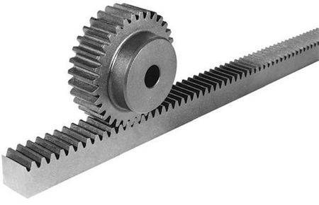

My reasoning that the wheel must turn the same number of times at any speed is the following:
Suppose the wheel is a gear and the road is a gear track. The number of teeth of the road between start and finish has to be the same at any speed, and consequently also the number of turns of the wheel. So I assume that in the rolling case, without gears, the number N of turns must be conserved. In that sense I meant invariant.
In the case of gears, at first glance, the driver sees no Lorentz contraction, Road Length = Number of teeth x Nominal Distance between teeth, except that if he measures the distance between teeth, perhaps with lasers and clocks, he sees a Lorentz contraction . Then it concludes that L = Number of teeth x Nominal Distance between teeth/γ
However in the case of rolling, which I think we can imagine as gears with teeth of infinitesimal spacing, the driver thinks: The number of wheel turns N is the same, the wheel is circular, its radius R remains the same, and pi is pi, therefore L = N.2πR, and there is not contraction, what of his assumptions is wrong?
You are further assuming that the same gear which meshes with the track at low speeds will mesh with the track at high speeds. That, mathematically, cannot be the case. There is no Born rigid transformation between the low speed gear and the high speed gear. The gear must unavoidably undergo strain in going from the low speed to the high speed scenario.

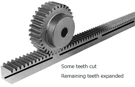

Say car speed v is almost light speed, in pilot's IFR wheel turns infinitesimal angle of less than one tooth of gear in wheel which should correspondent to many teeth of line. It is impossible. Teeth of line is so densed by Lorentz contraction to pinch teeth of wheel between. Gear track does not seem to work for relativistic speed.
[EDIT] To make it work we can apply dense-sparce asymmetric design to teeth of wheel and to teeth of line. Line teeth width and distance to next tooth should be expanded by factor ##\gamma##.
The teeth-and-gear model is suspect because it contains a bunch of unstated assumptions about the rigid geometry of the wheel and these assumptions fail at relativistic speeds. We can fix this by using @PeterDonis's formulation of the invariant (" the number of times a given spot on the wheel contacts the road during the trip") and yes, that is indeed the same in both frames.
The cause of the apparent paradox is the bogus assumption that the circumference of the wheel is ##2\pi R## where ##R## is the radius of the wheel when it is not turning. It's not, although the effect is completely insignificant except at relativistic speeds so is usually ignored, and it is different in different frames.
