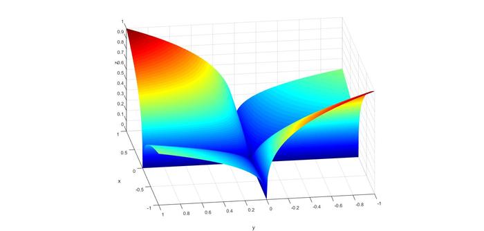

So I decided to just go ahead and graph this function in Matlab. I used meshgrid and symbolics to get two different but similar graphs.
1) meshgrid
[x,y] = meshgrid(-1:0.01:1);
z = (x.*y).^(1/3);
z = real(z);
surf(x,y,z), axis equal, xlabel('x'), ylabel('y'), zlabel('z'), shading interp, colormap(jet)

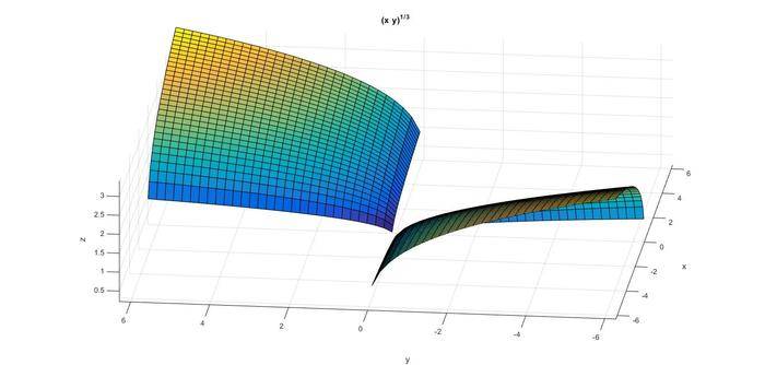

2) using symbolics and ezsurf
syms x y
ezsurf((x*y)^(1/3)), axis equal, xlabel('x'), ylabel('y'), zlabel('z')
Why does using the symbolic ezsurf throw out half the surface? It must be related to taking only the real values for z in meshgrid yes??
So the meshgrid form interpolates points around the origin, suggesting that the surface exists at the origin, but the symbolic toolbox suggests that the surface doesn't exist at the origin.
I am very confused. Please help :)
The question about directional derivatives is based on the definition of a derivative as the ##\lim_{|h|\to0} \frac{f( x+h_x,y+h_y) - f(x,y) }{|h|} ## looking at it this way, you allow for h to be a vector in any direction on the x-y plane.
You should be able to show that this limit is continuous if h only has x components or y components, but as soon as you have both, the limit is not the same for h as it is for -h and therefore the derivative does not exist in that direction.
Considering that explanation, look again at your plot, and you should see what I am saying.
