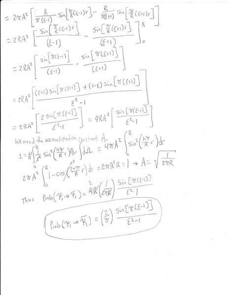

My solution is in the attached images. I know typing it out would have been ideal but it would have been too much and I could give more of my work this way. I scanned them to make sure they were high quality images.
I don't know where my thought process went wrong, but what I am getting for part (iii) is obviously wrong since it diverges at n=2.
  • Handwritten derivation titled Problem 4 (i) computing the overlap integral of a particle-in-a-box ground state with the new state after a sudden well expansion, including the identity for sin α sin β.
  • Handwritten derivation on lined paper: a chain of equalities simplifying a sine-integral expression, a normalization integral giving A = sqrt(1/(2πR)), and a boxed final probability (2/π) Sin[π(ε-1)]/(ε²-1).

Generally, your work looks good. But,
(1) Make sure you distinguish between probability amplitude and probability.
(2) When R is switched to R/ε, the normalization constant for the new eigenstates will depend on ε.
(3) It is not true that ##\frac{\sin(n\pi/2)}{n^2-4} = \frac{(-1)^{2n+1}}{n^2-4}##. For example, let n = 4. Also, n = 2 will need special treatment.
Oh I forgot to replace n with 2n+1 in the denominator. After doing this, I get the second form of the second equation listed in the problem, except, It needs to be squared. In other words, I get.. (We will call it P)
[tex]P=-\frac{8}{\pi}\frac{(-1)^{2n+1}}{(2n-1)(2n+3)}[/tex]
So in order to get the summation, I need to first square this, THEN sum over n. I cannot determine if this makes sense or not. That means I am summing up the ##P^2## values, not the ##P## values.
Your expression for P is off by an overall numerical factor because you have not normalized the wave functions correctly for the case where the radius of the well is ##R/ \epsilon##.
When you correct for this, you will have expressions for all of the transition amplitudes from the initial state to final states with odd quantum number ##\psi_{2n+1}##. You found that the transition amplitudes to states with even quantum number are zero. But there is an exception: the transition amplitude to ##\psi_2## is not zero.
I believe I got it. Re-writing the normalization constant, I got a factor of 1/2. Meaning the summation I showed in my previous post is equal to 1/2. I then used l'hospital's rule for when n=2 and got that term to be equal to 1/2. So 1/2+1/2=1.
Hopefully, this is it. Thank you very much for your help!
Good.
Another option for handling the n = 2 case is to set up the transition amplitude integral specifically for n = 2 and ##\epsilon = 1/2## and show the integral is ##\frac{1}{\sqrt{2}}##. So the probability for this transition is 1/2.
