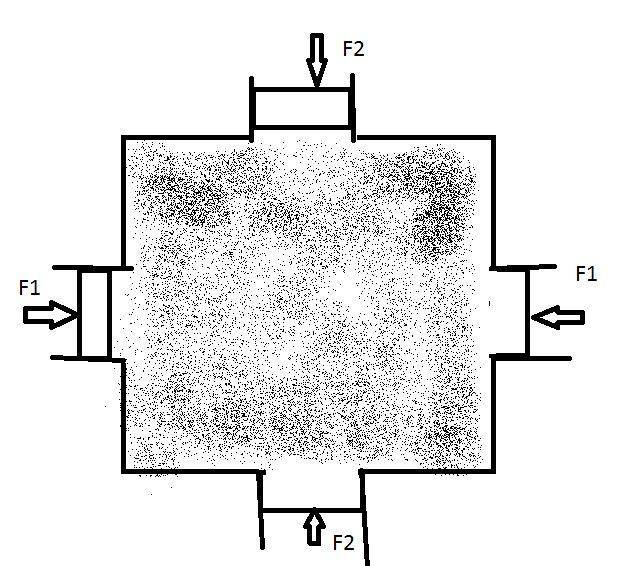

a water filled symetrical container has four pistons , one on each side of area A to keep water in equilibrium
Now an additional force F is applied to all four pistons . then increase in pressure at the middle of container will be:
pascal law: change is pressure is transmitted to whole fluid
since F is applied from four sides so pressure should have been 4F/A but the solution says F/A

What's the definition of pressure?
Perpendicular force per unit area..
Now apply that definition to the problem.
but the force is from all sides so either vector sum should be 0
or if add as scalar it should be 4F/A...
but the answer is only F/A
The force is being applied to a fluid, not a solid. What happens when you stand on a water balloon?

4F/4A is the same thing as F/A. If we're discussing pressure as a thermodynamic variable, it's what is called an intensive variable, independent of the size of a system. Mathematically, it's a scalar. Force has a direction, yes; force per unit area has no direction. Pressure times area has a direction. The scalar-vector conflict may be what's confusing you. Stick with it, and we'll sort it out for you.
