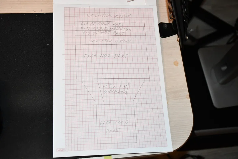

I do not understand you. Think If we want to cool computer chip, need to split thermopar into two parts with a flexible semiconductor. For example, apply cold part to the chip, hot part insert in laptop lid.
Could you explain how you think your idea of a cooling system would work - along with a diagram or a reference to one? Thank you.
Now idea is simple, perhaps it will turn out like this?
I have not seen any real examples of such devices.
The extended 'Flexible Semiconductor' has electrical resistance, and thus I2R losses to be overcome, so could be a No-Go from that perspective. I can't say one way or the other since off hand I do not know. Maybe that is the reason the Peltier devices are thin compact sheets, or it could be something else.
