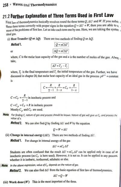

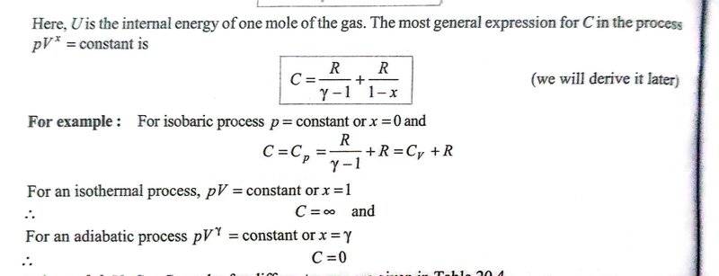

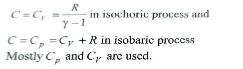

Homework Statement:: I am trying to understand a formula given in our book for determining molar heat capacity of an ideal gas under different thermodynamic processes using a single formula, but it is confusing. The exact formula for different processes is in the screenshots below. Can someone please explain how ##x## is calculated for different processes? The power of x is confusing me.
Relevant Equations:: As given in screenshot
To apply the formula for molar heat capacity using the equation mentioned above, one needs to first determine ##x## value and plug it into the molar heat capacity formula. But I am hitting a roadblock in finding ##x## for certain processes like isochoric, isothermal and adiabatic processes. I do get it for isobaric process.
The equation ##PV^x = constant ## doesn't make sense to me for isochoric process, in which ##V## is constant. To satisfy the above equation. ##x## would need to take a value so the left side of the equation is constant i.e. as ##P## increases, ##V^x## should decrease making ##x## take a variable set of multiple values. If, we can conclude that ##x= \infty ## then the second term on right hand side will be ##\frac {R}{1- \infty} = 0##, then the formula makes sense for isochoric process.
For isobaric process I get it. Since ##P## is already constant, so we need to only make sure that ##V^x## is constant, which is only true if ##x=0##.

The generic ideal gas equation of state is PV=nRT. Assuming that the amount of gas does not change, you can write it as PV=kT. The isothermal, isobaric and isochroric EOS’s should be derived from in directly. Your book should have the adiabatic derivation of PVϒ=constant.
I get the adiabatic part that you mentioned which is based on derivation, but the book uses the value of x for other processes. I was hoping to know how the x value is reached.
My bad. The book says that it derives the equation later. Is that derivation consistent with V=constant?
If ##pV^x=constant## for very large x then as p varies V hardly changes. In the limit, it doesn’t change at all.

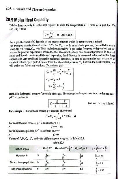

Below are screenshots of full page from where the original post screenshots were extracted.
Screenshot 1
Screenshot 2

I think for adiabatic process of ideal gas we know that ##PV^{\gamma} = constant ## is always true ( we don't care about the derivation of this equation for now since the goal is determining ##x## for different thermodynamic processes). Then we compare above equation with ##PV^{x} = constant ## and we get ##x= \gamma##. So, I am now also clear how ##x## is obtained for an adiabatic process.
vcsharp2003 said:
I think for adiabatic process we know that for an ideal gas ##PV^{gamma} = constant ##. Then we compare above equation with ##PV^{x} = constant ## and we get ##x= \gamma##. So, I am now also clear how ##x## is obtained for an adiabatic process. My problem is only that I want to know how ##x## value is arrived at.
For a constant volume process, ##\Delta Q = \Delta U##. I believe that when you look at the derivation of the equation, you will see that they using ##\Delta Q = \Delta U + W##. The infinity is essentially showing up to drive W to zero. They say “we will derive it later“ on page 208 after the boxed C equation.

I think the following may be an apt way of getting the value of ##x## in an isochoric process.
We need to satisfy the equation ##PV^{x} = constant## when volume ##V## remains constant. We know for an isochoric process, the pressure ##P## must change and the only way ##PV^{x} = constant## is if ##V^x =0## else if we take finite value of ##x## then ##V^x## will be some constant number causing ##PV^{x} ## to not remain constant as ##P## varies . Thus ##V^x= 0 \implies x=-\infty##.
Now if we plug in ##x=-\infty## into the equation ##C = \frac {R}{\gamma -1}. + \frac {R}{1 -x}## then we get the second term on right hand side as ##\frac {R}{1 - (-\infty)} = \frac {R}{\infty} = 0##. That gets us the correct formula for C in isochoric process using the framework mentioned in my original post. We get ##C = \frac {R}{\gamma -1} + 0## when volume ##V## is held constant.

If you rewrite ##PV^x=C## as $$P^{\frac{1}{x}}V=C^{'}$$you can easily see how ##x=\infty## gives constant V.

We rewrite it as $$\frac{V}{V_0}=\left(\frac{P_0}{P}\right)^{\frac{1}{x}}$$
Ok. So LHS would be a constant for isochoric process. This would means the RHS is also the same constant, which is only possible if ## x = -\infty##.
Or ##x=\infty##
