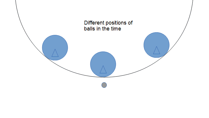

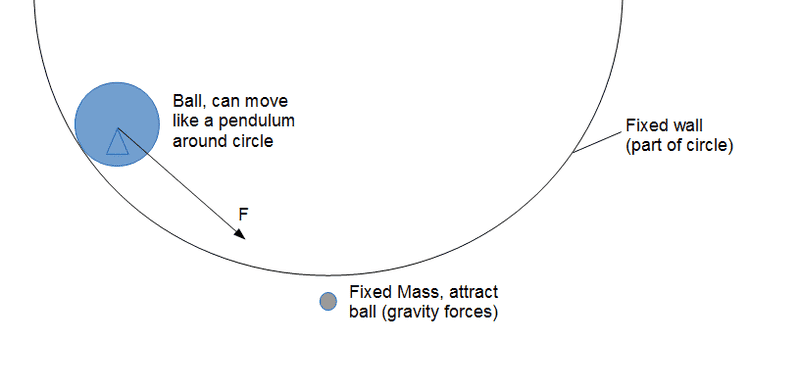

I would like to study a pendulum in 2D, not on Earth but only with one fixed mass attract a disk. Considered this fixed mass like a point. No friction on this theoretical study. The disk can move only around a part of circle. There are only 2 forces, F the attraction and N the force from wall (circle). The disk is composed with homogenous material, same density everywhere. The center of mass is fixed and it is in the center of circle of the disk. The center of gravity change always:
- it is more at center when the disk is far away the fixed mass
- it is more at outer circle of the disk when the disk is closed to the fixed mass
When I draw the trajectory of the center of gravity, it's not a circle. This would say the force from wall works.
But N seems to reduce the attraction F due to the non circle trajectory. So, I thought the energy goes to the angular velocity but N anf F don't give a torque because they pass trought the center of mass.
I tested an example with Algodoo software (2D software), and it confirm no rotation of the disk, it confirm too the lost of energy, sure it's not a professionnal software, maybe it's an error, like me the software see a non circle trajectory. I put an example, Algodoo is a free software.

f1: the system
f2: 3 positions of disk (examples)
f3: N and F forces, orange point is the center of gravity
So,
1/ The disk have a torque or not ?
2/ The trajectory of the center of gravity is perpendicular to the force from wall or not ?

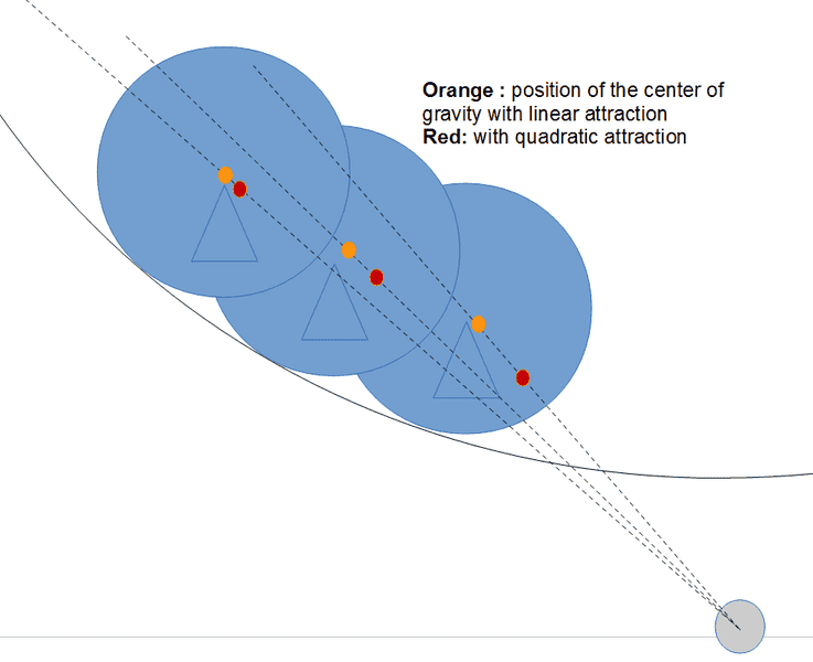

Thanks for links but I can't resolve that. It's not possible to calculate only 2 closed points of the center of gravity for show the trajectory and look of the angle ? Even, I don't know when the disk is on a precise part of circle I know all points. I don't know how to calculate the position of the center of gravity in the disk, can you explain this please ?
NB: like the function of attraction can be other than quadratic, for example linear (in Algodoo it's possible to choose linear too), I can't imagine the trajectory of the center of gravity always perpendicular to the force from wall with all functions : linear, quadratic, cubic, etc. Even in a small part of circle the force from wall must be always perpendicular to the trajectory of the center of gravity. For a small part, all positions of disk are known, but trajectories of center of gravity can't be the same with all functions I think. For one position of the disk the force from wall is always the same (for all functions of attraction) but each function of attraction change the position of the center of gravity with different ways ("force"), each trajectory is different for each function.
Sure, just put a different form for the potential energy in your Lagrangian.
No, it doesn't. I don't know why you would think that. The force from the wall will be perpendicular to the trajectory of the center of mass, but not necessarily the center of gravity, particularly for non-uniform gravity potentials.

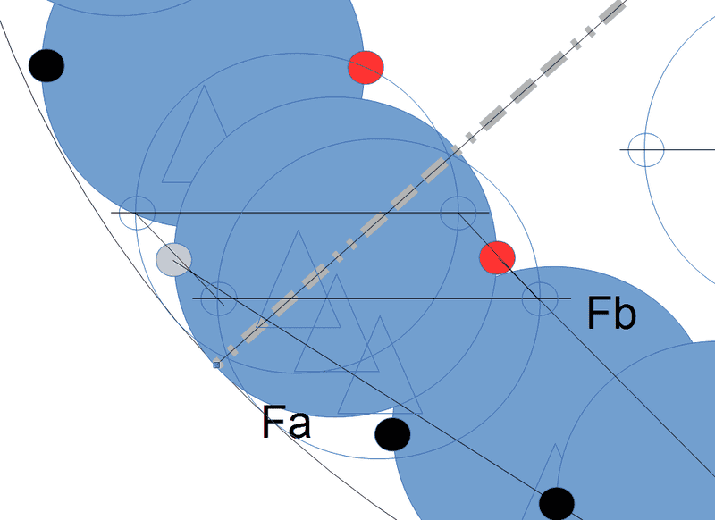

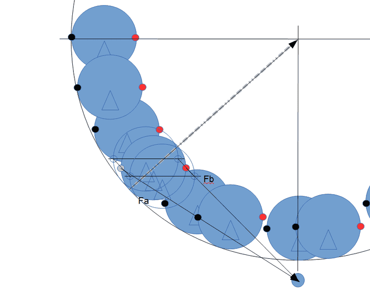

for me it was the sum of each attraction force multiply (vector) by force from wall (N). For one force of attraction, N works in positive and for another force N works in negative, the sum is zero, so N don't works. For me it was logical to take center of gravity not center of mass. I hope you can understand what I think ?For study some points, it's possible to take a disk composed with 2 points (red and black in image). Fa and Fb are very differents in value.
geometric example:
angles are:
black point: -32.4° for Fa, -46.15° for movement
red point: -45.68° for Fb, -47.19° for movement
the force from wall is 41.68 °
Angle between force and wall is :
black point: 87.83 °
red point: 88.87 °
With 2 points the disk turn, but with a lot of point around circle, the disk don't turn and for each point on the circle the angle is lower than 90°. It's possible to take smaller circle and at final if this work with all circles it works for a disk. In each case the force from wall is not perpendicalar to the movement.
In this example, can you explain where is my error ?
No, I don't understand why you would think that is logical. The center of gravity is relevant only for the gravitational force. It has no relevance whatsoever to the normal force.
Regarding your drawing. It is entirely too cryptic for me to discern. You will have to troubleshoot it yourself. I have already told you how I would approach this problem, if you choose to ignore my advice and approach the problem in a more difficult way then you will undoubtedly run into many unnecessary problems.
