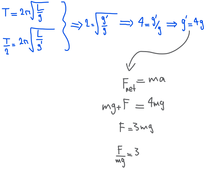

The period of a simple pendulum with an iron ball is T. If we put a magnet under it, its period becomes T/2. What is F/mg equal to?(F is the force that is exerted by the magnet.)
T = 2π Square root of√L/g
Hi ...
I have answered this question and I think that F/mg equals 3.
But I've asked it from someone and he told me that F/mg is 4.
Can someone help me find out which one is correct ???
My answer :
I'm with you.
My guess is the other solver forgot gravity still acts when the magnet is present.
Yes he said he ignored gravity.
Thank you for your time.

haruspex said:
Owing to a breakthrough in metallurgy, it is superconducting.
I didn't understand ...
Can you please tell me if you disagree with my answer ...
It was just an attempt at a humorous response to @kuruman's nitpick.
I agree with your answer.
I understand ...
Thanks again ...
I too agree with your answer. I am sorry that my attempt at levity confused you.
