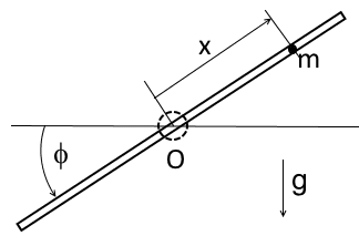

Consider the following mechanical system
Diagram of a thin tube pivoted at its centre O, tilted at angle phi above the horizontal, with a ball m at distance x along the tube and a downward arrow labelled g.
A thin tube can rotate freely in the vertical plane about a fixed horizontal axis passing through its centre ##O##. A moment of inertia of the tube about this axis is equal to ##J##. The mass of the tube is distributed symmetrically such that tube's centre of mass is placed at the point ##O##.
Inside the tube there is a small ball which can slide without friction. The mass of the ball is ##m##. The ball can pass by the point ##O## and fall out from the ends of the tube.
The system undergoes the standard gravity field ##\boldsymbol g##
It seems to be evident that for typical motion the ball reaches an end of the tube and falls down out the tube. It is surprisingly, at least for the first glance, that this system has very many periodic solutions such that the tube turns around several times during the period.

This is a representation of one of the solutions, found with the NDSolve function of Mathematica, and by trial and error on the initial conditions:
https://dl.dropboxusercontent.com/u/503888/file.gif
Yes, such a type solution can be found by linearization of system (1.1) near the equilibrium ##\phi=0,\quad x=0##. But the article is about completely different periodic solutions. It is about the solutions such that the tube rotates several times during the period.

Another possible motion
https://dl.dropboxusercontent.com/u/503888/file2.gif
and the corresponding time diagrams
https://dl.dropboxusercontent.com/u/503888/graphics.png

@Vincenzo Tibullo: Great example.
Can you share the inital values?
For the easiest motion (k=0) I found x=1, θ=0.4622, ##\dot x = \dot \theta = 0## at t=0. It is unstable, not surprising I think. I would expect all solutions to be unstable.
I wonder how solutions with very large k and small ω look like. Wild rotations with tiny motion of the masses, but how does that give a periodic orbit?
