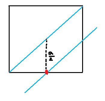

The question is as attached in the picture.
I understand and got the answer to part (a) but from (b) onwards I am completely lost. Here are my assumptions:
1)Edges of 'cube' are still of length a
2)Successive planes are parallelBut, there is some things remain unknown:
1)Where is the origin at? The centre of the cube? or at the bottom leftmost point?
2)Why does the plane pass through (a/2, 0, a/2)?
3) Do we assume that the plane contains the origin? Then won't the equation be
r . n = 0?
would appreciate any help..
The description states, the center of the cube.
There is an atom at (a/2, 0, 0) through which a plane has to pass; so it passes through (a/2, 0, z) for any z because it is parallel to the z axis. I am not sure why they did not specify the obvious point, though.
r . n = 0?
It is another plane that satisfies the equation, but not for a positive p. They actually use this plane implicitly when they claim that the p found is the distance between the planes. Can you see how?

I do not think we are getting anywhere. The first plane with the given normal vector passes through the atom at (0, 0, a/2), and that plane passes through the origin. There is a plane that passes through (a/2, 0, 0), which also passes through (a/2, 0, a). You say this the third plane. Where is the second plane? What atom does it pass through?

No, no what I meant was that:
First plane: passes through (0,0,0) and (a/2, 0, 0)
Second plane: the 'usual' base/top of a cube plane
Third plane: the plane that passes through the atom on every alternate level that is centred on a face (a/2, 0, a)
Assumptions: vertical distance between planes is a/2.
These planes do not have (1, 1, 0) as their normal vector.
Hmm? I thought they are parallel with one another? Then the normal vector should be the same? (Or does the normal vector depend on perpendicular distance to origin? )
I fail to see how. The plane passing through the origin with the normal (1, 1, 0) cannot possibly pass through (a/2, 0, 0). This is seen from its equation: (1, 1, 0)(0, 0, 0) = 0, and (1, 1, 0)(a/2, 0, 0) = a/2 ≠ 0.

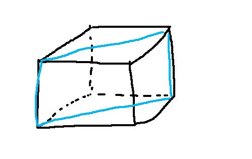

That is true...But doesn't the first plane 'cut' the cube into half and by right should contain the atom that is the centre of a face?
The first plane cuts the cube diagonally. Its projection onto the XY plane is a straight line passing through the upper left corner to the bottom right corner. It does pass though an atom at the middle of the face, but that is (0, 0, a/2), (0, 0, -a/2), etc.
Is this what you mean?
Exactly.
Now if you add an atom in the center of the "frontal" or the "right" face, and draw a plane passing through it parallel to the plane in blue, you will get the plane they considered in the solution.
I see!
So, it must pass through the point (a/2,a/2,0) that is directly below the red point as in the answer!
I think the question assumes that the vertical separation is a/2..
But I am not sure how they got the answer to the last part with normal (1,1,1)..
I think you are slightly confused by 3D to 2D jumps :)
In 2D, we usually have X left to right, and Y bottom up. That's what I implied saying that in the XY plane, the line that is the projection of the plane is upper left to bottom right. So rotate your 2D picture 90 degrees counterclockwise. The red point will then be at (a/2, 0).

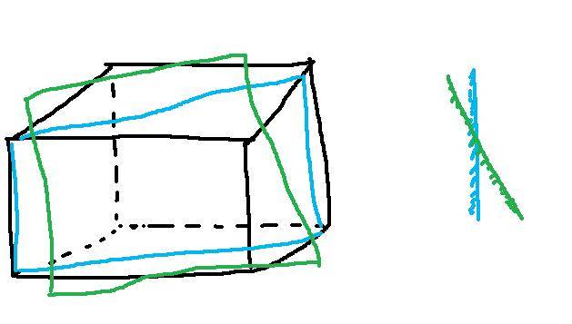

The last part with the normal (1,1,1) is very hard to vizualize and I can't seem to find any obvious point that lies on it..
I think you could begin by drawing the lattice and the normal.
Yeah I got something like this:
It's very hard to locate a known/obvious point that lies on the 2nd layer of green plane...
