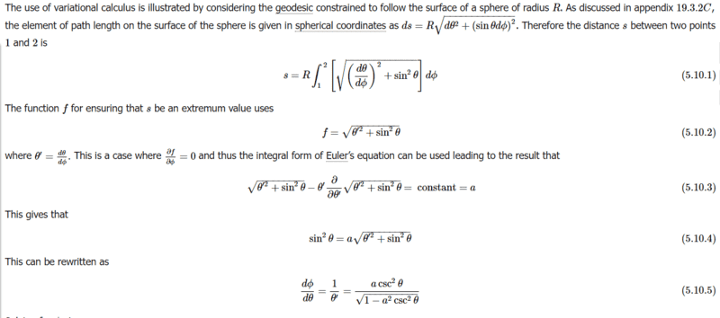

For the sphere, My answer is completely similar to this:
Text page with equations (5.10.1) to (5.10.5) for geodesics on a sphere: arc length integral in spherical coordinates, f = sqrt(theta'^2 + sin^2 theta), Euler equation result sin^2 theta = a sqrt(theta'^2 + sin^2 theta), and dphi/dtheta = a csc^2 theta / sqrt(1 - a^2 csc^2 theta).
My problem is that I don't know how to obtain 5.10.5 using 5.10.4 ...

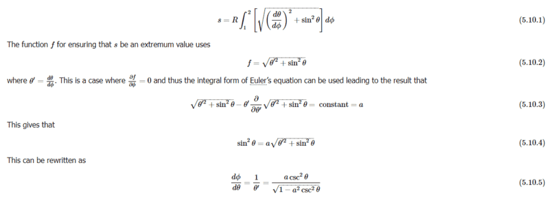

  • Typeset equations (5.10.1) to (5.10.5): arc length s = R times the integral of sqrt((dθ/dφ)^2 + sin^2 θ) dφ, f = sqrt(θ'^2 + sin^2 θ), the integral form of Euler's equation, sin^2 θ = a sqrt(θ'^2 + sin^2 θ), and dφ/dθ = 1/θ' = a csc^2 θ / sqrt(1 - a^2 csc^2 θ).

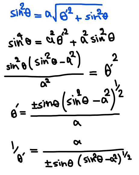

Handwritten derivation: sin^2θ = a√(θ'^2 + sin^2θ), squared to sin^4θ = a^2θ'^2 + a^2 sin^2θ, then solved step by step for θ' and 1/θ'.
I've done that before. I forget to post it.

docnet said:
$$\begin{align*}
\sin^2\theta &= a\sqrt{\theta'^2+\sin^2\theta}\\
\sin^4\theta &= a^2(\theta'^2+\sin^2\theta)
\end{align*}$$
Thanks, But I don't see any problem ...
That's because there isn't a problem.. I'm sorry I hit post before I was finished typing.

If you still wanted to know how to get (5.10.5) from (5.10.4):
\begin{align*}
\sin^2\theta&= a\sqrt{\theta'^2+\sin^2\theta} \\
\sin^4\theta &= a^2 (\theta'^2+\sin^2\theta) &\text{squared both sides} \\
\sin^4\theta &= a^2\theta'^2+a^2\sin^2\theta\\
\theta'^2 &= \frac{\sin^4\theta - a^2\sin^2\theta}{a^2} &\text{solved for } \theta'^2\\
\theta'^2 &= \frac{1-\frac{a^2}{\sin^2\theta}}{\frac{a^2}{\sin^4\theta}} &\text{divided numerator and denominator by } \sin^4\theta\\
\theta' &= \frac{\sqrt{1-\frac{a^2}{\sin^2\theta}}}{\frac{a}{\sin^2\theta}}& \text{square rooted both sides}\\
\theta' &= \frac{\sqrt{1-a^2\csc^2\theta}}{ a\csc^2\theta}\\
\frac{1}{\theta'}&= \frac{ a\csc^2\theta}{\sqrt{1-a^2\csc^2\theta}}.
\end{align*}
