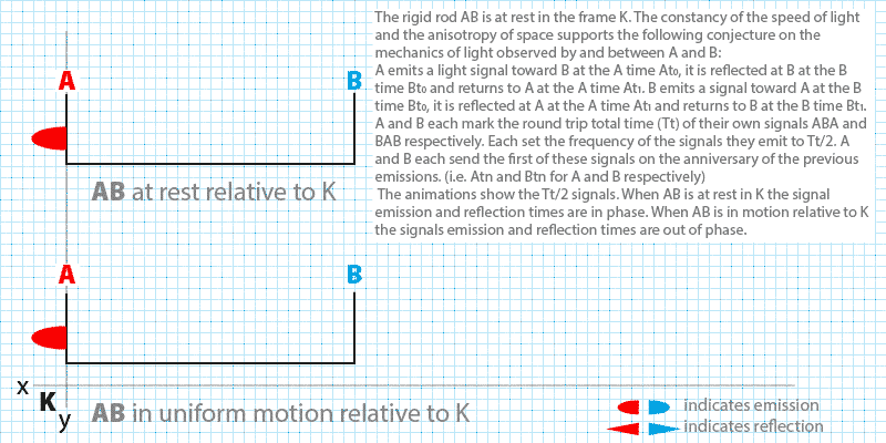

I would appreciate knowing if there is any error in the mechanics illustrated in this animation with respect to phase change in the signal reflections shown at A and B, or in the description accompanying it.
I have embedded the description with the animation and included it in this post for reference and quoting purposes.
Thank you.
The rigid rod AB is at rest in the frame K. The constancy of the speed of light and the anisotropy of space supports the following conjecture on the mechanics of light observed by and between A and B:
A emits a light signal toward B at the A time At0, it is reflected at B at the B time Bt0 and returns to A at the A time At1. B emits a signal toward A at the B time Bt0, it is reflected at A at the A time At1 and returns to B at the B time Bt1. A and B each mark the total time (Tt) of their own signals ABA and BAB respectively. Each set the frequency of the signals they emit to Tt/2. A and B each send the first of these signals on the anniversary of the previous emissions. (i.e. Atn and Btn for A and B respectively)
The animations show the Tt/2 signals. When AB is at rest in K the signal emission and reflection times are in phase. When AB is in motion relative to K the signals emission and reflection times are out of phase.
This is nonsense. Your emission of the blue flash on the top has nothing at all to do with the emission on the bottom. You need to use the Lorentz transform if you want them to be related to each other. Just randomly animating things doesn’t mean anything.
Phase is a relativistic invariant. All frames agree on the phase at any event

Yes, there is. If the light signals are in sync when they reach A and B in one frame, they must be in sync in every frame. The light signals reaching A and B are invariant events.

The animations are not a comparison of observations from two different reference frames.
Both animations are relative to K.
The time of emission from B, the blue signal, is the same time in both “animations” whether you choose a clock at rest with K or AB.
To establish this time of emission we divided the round trip times in half when AB is at rest with K, ABA/2 and BAB/2
When the time AB = BA. which is true when AB is viewed from and at rest with K, the emission of blue from B will coincide with the reflection of red at B.
When AB is in motion relative to K, AB≠BA. The first leg of the red signal AB does not equal the first leg of the blue signal BA. This puts the times of reflection of red and blue out of phase.

It is certainly possible to build such a pair of devices: one that is in phase and another that is not in phase.
This has nothing whatsoever to do with relativity, and as far as I can tell demonstrates no important physics principle. But it is physically possible to build two such devices.
These are two physically distinct devices, not identical devices operated in relative motion. In any frame the out of phase device produces out of phase signals and the in-phase device produces in-phase signals. Again, phase is a relativistic invariant.

No, what put them out of phase is that you changed the scenario. You defined the "moving" scenario as physically different from the "stationary" scenario by having the red signal emitted from B before the blue signal arrives at B, instead of at the same instant. That's a change you made in specifying the second scenario. It tells you nothing whatever about the laws of physics. All it tells you is that you changed the scenario.

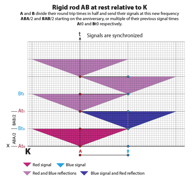

robphy said:
In my opinion, while animations of boxcars in space are nice,
an even better description is a spacetime diagram of the situation.
I will give light cones my best shot, and leave spacetime diagrams to those more capable.

Those are nice diagrams but there is still no physics content to the scenario, regardless of how you display it. You have simply deliberately introduced a phase shift in one case and not in the other. Why you choose to introduce the phase shift for the “moving” one is a question of your own personal decisions, not a question of physics.

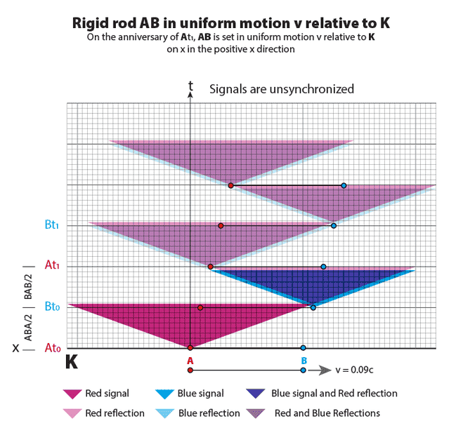

I wasn’t aware I “chose” to set a phase shift for the moving AB. The time it takes light to travel from A to B is longer (for both observers) than the time to travel from B to A when AB is moving toward the direction of B. Are you saying that is not the case?

Notice that in the moving apparatus the emission from the right side occurs before light reaches it. So the emission from the right is not caused by the emission from the left. It simply happens according to some pre-arranged decision. Its timing is not derivable from any of the physics of the scenario.

In your animation the Blue light is very clearly emitted from B before the Red light arrives at B. That is precisely the problem. That requires a prearranged emission at B. Otherwise some faster-than-light signal from A would be needed.

Note that both blue flashes are emitted simultaneously in the frame in which the animation is drawn. I think the lower rod is, for some reason, using clocks de-synchronised and rate-adjusted so that they match those in the frame where it is moving in order to time the emission of the blue light. Disrupting the functioning of your clocks is a silly thing to be doing if you're trying to test something to do with speed, but it's possible to do.
Ibix said:
I think the lower rod is, for some reason, using clocks de-synchronised and rate-adjusted so that they match those in the frame where it is moving in order to time the emission of the blue light. … it's possible to do.

The emission time of the Blue light from B is not pre-arranged, it is a calculated time based on c and the Einstein convention of two-way light speed as follows:
You seem to be under the misapprehension that, in a frame in which A and B are moving, this procedure will lead to signals that look like the second diagram you drew. It won't. It will lead to signals that look like the first. By your description, A and B use their own clocks in the setup process, and then again use their own clocks to determine their emission times. That, combined with the simultaneity convention that results from their using Einstein synchronization (which is basically what your process amounts to), means that everything will look the same in any frame as it does in A and B's rest frame. The signals will always be in sync as they are in your first diagram.
In short, the only way to get the signals to look the way they do in your second diagram is to not use Einstein synchronization, but to use some other pre-arranged procedure to determine when B, by B's clock, emits his first signal.
