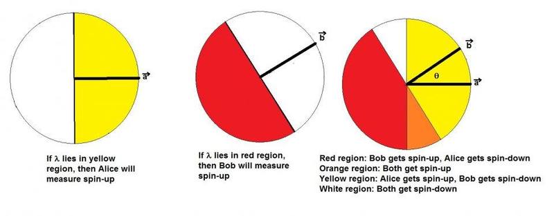

The idea behind the following picture is this:
Alice picks axis [itex]\vec{a}[/itex] and Bob picks axis [itex]\vec{b}[/itex]. You can always choose a coordinate system such that [itex]\vec{a}[/itex] is in the x-direction and [itex]\vec{b}[/itex] is at an angle [itex]\theta[/itex] away from [itex]\vec{a}[/itex] in the x-y plane.
The intrinsic spin vector, [itex]\vec{\lambda}[/itex], can be in any direction, but we can write it as [itex]\vec{\lambda} = \vec{\lambda_z} + \vec{\lambda_{xy}}[/itex], where [itex]\lambda_z[/itex] is the component of [itex]\lambda[/itex] in the z-direction, and [itex]\vec{\lambda_{xy}}[/itex] is the component in the x-y plane. For the purposes of determining whether Alice and Bob get spin-up or spin-down, only [itex]\lambda_{xy}[/itex] is relevant, so in the diagram, [itex]\lambda[/itex] just refers to this component in the x-y plane.
So if [itex]\lambda[/itex] is in the x-y plane, we assume that it has equal likelihood of pointing anywhere in the x-y plane.
So let [itex]A[/itex] be Alice's result and let [itex]B[/itex] be Bob's result. The first picture shows how Alice's result depends on [itex]\lambda[/itex]: If [itex]\lambda[/itex] lies anywhere in the yellow region, then Alice gets +1. Otherwise, she gets -1. The second picture shows how Bob's result depends on [itex]\lambda[/itex]: If [itex]\lambda[/itex] is in the red region, Bob gets +1, and otherwise, he gets -1.
The third picture shows the joint probabilities: Alice and Bob get the same result if [itex]\lambda[/itex] is in the orange and white regions, which occur with probability [itex]\theta/\pi[/itex]. Alice and Bob get opposite results if [itex]\lambda[/itex] is in the yellow or red regions, which occur with probability [itex](1 - \theta/\pi)[/itex]. So the product [itex]A B[/itex] is +1 with probability [itex]\theta/\pi[/itex] and [itex]-1[/itex] with probability [itex]1-\theta/\pi[/itex]. So the expectation value of [itex]A B[/itex] is [itex](+1)(\theta/\pi) + (-1) (1-\theta/\pi) = -1 + 2\theta/\pi[/itex]
Thanks for this. I can't see though how you can factor out the orthogonal component in the way you are suggesting. Angles in 2 dimensions are closer than in 3 CosA=CosB CosC

  • #69
The three-dimensional way of seeing it is by considering a sphere of radius 1, which you can think of as a globe. Every unit vector in space corresponds to a unique point on the surface of the sphere. For any point on the sphere, there is a corresponding hemisphere consisting of the half of the sphere that is closest to that point. For example, on the globe, the hemisphere corresponding to the North Pole is the northern hemisphere.
So in terms of the sphere, the rules for computing Alice's and Bob's results are:
  • If [itex]\lambda[/itex] lies in the hemisphere corresponding to Alice's setting [itex]\hat{a}[/itex], then she gets +1.
  • If it is in the other hemisphere, she gets -1.
  • If [itex]\lambda[/itex] lies in the hemisphere corresponding to Bob's setting [itex]\hat{b}[/itex], then he gets -1 (because his particle is anti-correlated with Alice's, meaning it has the opposite sign for results).
  • Otherwise, Bob gets +1.
So we have two hemispheres: the one corresponding to Bob's setting, and the one corresponding to Alice's setting. There are 4 possible cases for [itex]\lambda[/itex]:
  1. [itex]\lambda[/itex] is in the intersection of Alice's hemisphere and Bob's hemisphere. In this case, Alice gets +1, and Bob gets -1, so the product of their results is -1.
  2. [itex]\lambda[/itex] is in Alice's hemisphere, but not Bob's. In this case, both get +1. So the product is +1
  3. [itex]\lambda[/itex] is in Bob's hemisphere, but not Alice's. In this case, both get -1. So the product is +1.
  4. [itex]\lambda[/itex] is in neither hemisphere. In this case, Alice gets -1, and Bob gets +1. So the product is -1.
So this divides the sphere up into 4 regions. Let [itex]\mathcal{A}[/itex] be the area of the intersection of Alice's and Bob's hemispheres. Alice and Bob's hemispheres each have area [itex]2 \pi[/itex] (a full sphere of radius 1 has area 4 [itex]\pi[/itex], so a hemisphere has area [itex]2 \pi[/itex]) Then
  • Region 1 has area [itex]\mathcal{A}[/itex].
  • Region 2 has area [itex]2 \pi - \mathcal{A}[/itex] (the area of Alice's hemisphere, minus the intersection with Bob's)
  • Region 3 has area [itex]2 \pi - \mathcal{A}[/itex] (the area of Bob's hemisphere, minus the intersection with Alice's)
  • Region 4 has area [itex]\mathcal{A}[/itex] (This might not be obvious, but it's true.)
So if we assume that [itex]\lambda[/itex] is equally likely to point to any spot on the sphere, then the probability of lambda falling in each region is given by [itex]\frac{area(region)}{4 \pi}[/itex]. So the probability that the product of Alice's result and Bob's result will be +1 is just the sum of the areas for regions 2 and 3 divided by 4 [itex]\pi[/itex]. So that's [itex]\frac{4 \pi - 2 \mathcal{A}}{4\pi} = 1 - \frac{\mathcal{A}}{2 \pi}[/itex]. The probability that the product of their results will be -1 is the just the sum of the areas for regions 1 and 4 divided by 4 [itex]\pi[/itex]. So that's [itex]\frac{2 \mathcal{A}}{4 \pi} = \frac{\mathcal{A}}{2 \pi}[/itex]. So the expectation value of the product is:
[itex]\langle A B \rangle = (+1)(1 - \frac{\mathcal{A}}{2 \pi}) + (-1)\frac{\mathcal{A}}{2\pi} = 1 - \frac{\mathcal{A}}{\pi}[/itex]
So the final step is to calculate [itex]\mathcal{A}[/itex]. This is easiest to calculate if you choose a coordinate system so that [itex]\hat{a}[/itex] and [itex]\hat{b}[/itex] both lie on the equator, at a distance of [itex]\theta[/itex] apart. It should be obvious (I hope) that [itex]\mathcal{A}[/itex] is proportional to [itex]\theta[/itex]. If you work it out, it turns out that [itex]\mathcal{A} = 2 \theta[/itex]. So once again, you get:
[itex]\langle A B \rangle = 1 - \frac{2 \theta}{\pi}[/itex]
It's the same result as I derived for the 2D case.

Thank you Steven Daryl for post #69. I have been drawing out the orange segments and I have it now!
