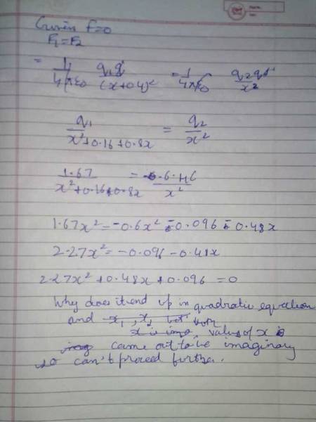

The question is this:
Calculate the position on the line joining 2 charges 1.67 uC and -0.6uC situated 0.4m apart where a third charge q does not experience any force?
uC=microcoulomb
  • Handwritten physics working on lined paper: two charges q1 = 1.67 µC and q2 = -0.6 µC placed 0.4 m apart, with a third charge q between them, and force equations for F1 and F2 with a net force relation.
  • Handwritten working solving for the zero-force point between two charges using F1 = F2, reducing to the quadratic 2.27x^2 + 0.48x + 0.096 = 0, with a note that the roots appear imaginary.
The reason it comes out as a quadratic equation because there are two places that satisfy the problem
(You can place it at a certain distance to the left of the charges, or a certain distance to the right of the charges.)
The reason your quadratic was imaginary is because you set up the initial equation wrong.
You want [itex]F_1+F_2=0[/itex] and therefore [itex]F_1=-F_2[/itex] (Whereas you wrote "[itex]F_1=F_2[/itex]" without the negative sign)
P.S.
In the future, it would be very helpful if you typed out your thoughts in the thread. The reason is that it can sometimes be difficult to read off of a picture. (And I almost didn't even notice that there were words in your picture!) Thank you :)
Let the point at which q[itex]_{3}[/itex] does not experience any force be x.(Let this x be measured from q[itex]_{1}[/itex])
Not distance of that specific point from q[itex]_{2}[/itex]=(0.4-x)
Since net force on q[itex]_{3 }[/itex] is zero so
kq[itex]_{1}[/itex]q[itex]_{3}[/itex]/x[itex]^{2}[/itex]=-kq[itex]_{2}[/itex]q[itex]_{3}[/itex]/(0.4-x)[itex]^{2}[/itex]
Put the values and get the answer.

It does give a solution. Please re-check your calculations, what equation do you get after applying the correction Nathanael suggested?
