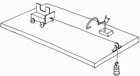

Plan an investigation to test how the size of the pulling force affects the average velocity of the trolley of the toy car
Well adding weight to the trolley is different from pulling it with a stronger force, right? If you add force by adding weight, as we've seen, the acceleration stays the same because of a=F/m.
To see that adding more pulling force increases the acceleration, you need to add more pulling force and not add mass to the trolley. You could use a string and pulley on the edge of a tabletop, for example, to pull the trolley with various forces via weights on the end of the string hanging off the table...
If i use a ramp, a pulley, weights to create the pulling force. Can i use the formula f=ma for average velocity then?
Not that I can see. Can you post a sketch of your setup, the free body diagram (FBD) of the trolley and the math that justifies doing so?
The set up:
We want to test the relationship of force and average velocity
Ayoub99k said:
The set up:
There is a fundamental problem with that: there is no specific relationship. It will depend on what is held constant.
If you run each test over the same distance but vary the weight, the average velocity will be found to vary as the square root of the weight; if instead you compare how far it travels in a fixed time as the weight changes, the average velocity will be directly proportional to the weight.
Likes berkeman
