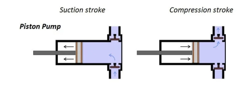

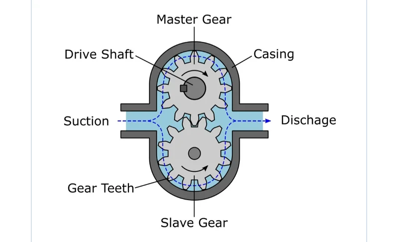

Hey guys, which one creates the higher vacuum (lower pressure vacuum)? A piston suction pump (that kind of looks like a syringe) or an external gear pump design (that used two external gears)? IMO I think it is the former but I want more explanations.
Welcome to PF.
The answer will depend on the required pressure and the volume that must be evacuated. The best pump will be the one with the least leakage.
I think my first choice would be an eccentric vane pump, with graphite vanes. Next would be a piston pump, and lastly, an external gear pump, which will have the highest leakage and need the most oil to seal the gear tips against the housing.

Thank you. As the piston pump is better suited for a vacuum pump design than the external gear pump design, I will pick the piston pump design that looks like a syringe or a piston bellows. What other reasons that make external gear pumps to be insufficient as vacuum pumps?
Rotary lobe pumps typically used as superchargers have similarities to gear pumps. They are mostly used for non-liquids. I guess it depends on how wrapped up into definitions you want to get.

A piston pump needs valves, a gear pump does not. If the valves are spring loaded, one way check valves, they will reduce the vacuum you can pull by the valve operating pressure. You will need automatic cam operated valves with your piston pump.

A piston pump with pressure operated check valves will not do as well as a vane or an external gear pump.

Even if both are designed as simple as possible? Now I'm curious about the Torr range that a piston pump with pressure operated check valves and an external gear pump can produce.
