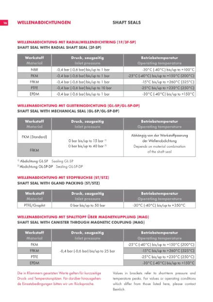

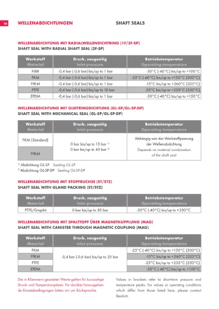

Thank you so much. The datasheet below at page 16 it said for some external gear pumps the inlet pressure is 0 bar bis/up to 15 bar while for others it is -0.4 bar (-0.6 bar) bis/up to 1 bar. I believe 0 bar represents the normal atmospheric pressure, because as we can see some have negative value inlet pressure. Is that correct?

Regarding my previous post about Beinlich external gear pump, does 0 bar represent normal atmospheric pressure?
That is a 20-page technical document. Please give the page number and identify the figure or table that refers to zero bar.

Page 16 of a technical catalogue titled Wellenabdichtungen / Shaft Seals, with tables of shaft seal types (radial shaft seal, mechanical seal, gland packing, canister with magnetic coupling) listing material, inlet pressure and operating temperature.
The file attached to post #45, appears to be different to the one you are looking at. It has a different page 16.

Oh sorry I posted the wrong PDF. Here is the PDF that I supposed to upload. It is on the pg. 16.

Since some of the inlet pressures are negative, the pressures must be referenced to atmospheric pressure = 0 bar, with a vacuum = -1.0 bar.
