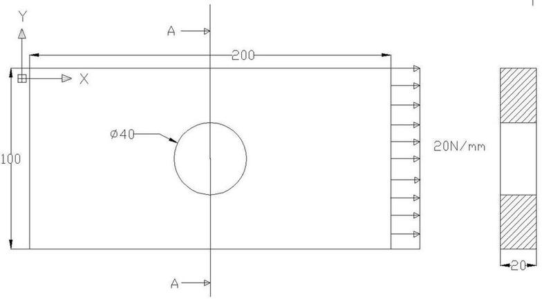

Hey, I'm trying to solve a little mechanics problem and I'm stuck.
I want to find the maximum stress in the system. I know that it should be at the top and bottom of the hole. The plate is fully constrained at the left edge.
I find the average tensile stress in section A:
sigma = F/A = 2000N/(100-40)*2 = 1,67N/mm^2
I also know that the stress distribution in section A is not even.
Could someone give me a little hint?
Thanks
You're missing a 0 on the thickness for the area calculation. Once that is taken care of, you need the stress concentration factor that will be a function of the width of the plate and the hole diameter. That will multiply the average stress to get your peak stress.
