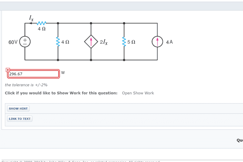

Please help to find the power supplied by the 4-A

Ab Zar
i solved 9 times all not correct please share with me what's wrong

What is the relationship between ##I_1## and ##I_x##? Are they really identical? How does this affect your constraint equation for the controlled source?
