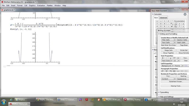

Hi.
According to the attached article I couldn't draw fig1 with eq1 using mathematica.

You realize that ##g(\bar\omega^2)## is defined by different equations depending on the value of ##\bar\omega^2##? And that the figure in the paper plots ##g(\bar\omega^2)## as a function of ##\bar\omega^2##, not ##\bar\omega##?

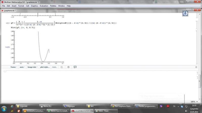

NascentOxygen and DrClaude, thank you for answers. I plotted this without elliptic integral. But this article referred to elliptic integrals. DrClaude, I am aware of your writings but mathematica has given error mesage:
Instead of using w^2 in the equation for g7, define a variable w2 that corresponds to ##\bar\omega^2##.
I had tried.
In the argument of the elliptic integral, you're missing the cube in ##(2-3\bar\omega^2)^3##.
You are right. But after I tried all variable ranges with correct code, nothing changed. Mathematica file is attached for anyone intersted in this plot. Thanks for help.

Looking at your file, you have in it
Code:
g2 = (9/\[Pi]^2) ((1 - 2 w)/(3 w (2 - 3 w)^3)^(1/2))
       (EllipticK[(1 - 2 w)/(w (2 - 3 w)^3)])^(1/2);
Plot[g2, {w^2, 0, 1}]
First, the argument of the elliptic integral is incorrect. The square root should be over the argument itself, not the entire integral. Second, you need to plot with respect to w, not w^2. Third, the equation for g you have there is only valid in the range ##1/3 \leq \bar\omega^2 \leq 1/2##. Therefore, you should have
Code:
      EllipticK[((1 - 2 w)/(w (2 - 3 w)^3))^(1/2)];
Plot[g2, {w, 1/3, 1/2}]

I will try to be as diplomatic as possible, but your latest post has made me cross. I was guiding you towards the solution to your problem, but instead of trying what I suggested, you reply without any new attempts.
vesta33 said:
I should stress that I know mathematica.
Then you should know why the statement
Code:
is not valid.
vesta33 said:
I had tried all possibly variaions before wrote here.
Obviously not, because you have not been able to reproduce the graph.
vesta33 said:
If anyone wants help me please first of all run the code.
I did, told you what was wrong, and even gave you a correct replacement code, which is at least valid for part of the ##\bar{\omega}## domain.
vesta33 said:
I think mathematica or the article has a bug.
Both are fine. I was able to reproduce the figure in a couple of minutes. Before you ask for my code, note that this is not how things are done on PF. We don't feed you fish, we help with the fishing.
