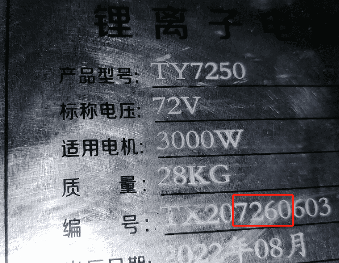

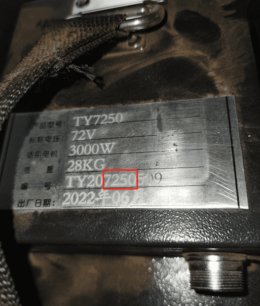

if i put graphene into a lithium battery improves the battery in anyway?
Well people i'm looking electric Motorcycles. And the same seller it's selling a 72V50Ah battery and a 72V60Ah battery, both IN THE SAME WEIGHT, every battery in the shop occurs the same. So or we have a factory mistake, scam, witchery .....or...graphene in the lithium. I have been reading that you can use graphene to improve batteries, hence, you can raise the power practically without extra weight using this extraterrestrial material.
¿True of Fake? or ¿Graphene witchery?

Lithium ion batteries already incorporate graphite as a standard anode material. Most proposals for graphene enhanced lithium ion batteries start with this in mind. In the commercial sector, graphene is almost always simply a marketing term used to refer to highly exfoliated and restacked graphite, rather than a single 2D layer of carbon. There are a few benefits from this: first, the exfoliation and restacking breaks up the crystallinity of graphite, which allows the anode to incorporate a higher density of metal ions, leading to a somewhat higher energy storage capacity. Another benefit is the amorphous nature of the graphitic matrix can sometimes facilitate faster charging.
Additionally, graphene has shown mixed results as a physical barrier for corrosion protection, which is of perennial concern in battery fabrication. I don’t know of any commercialization of this effect, though (mainly because it doesn’t work so well).

Regarding doubts, what I would worry about is not the graphene but whether I could identify the battery (and the manufacturer) based on that type number.
I couldn't.

The battery part number may be a custom packaging of standard cells. Device manufacturers often request a minor modification or slightly different packaging if ordering a large quantity of component parts. The component supplier then assigns a unique Part No.
This not only makes it easier for the end-product manufacturer, but also makes them the only source for a replacement part; much additional profit gained that way.
Anyhow, in a Google search, the first four hits show Li-Ion Protection Boards with part numbers that correlate with some data in the photos.
https://www.google.com/search?q="207260"+battery
Now, if someone that can read Chinese can be found...
Happy Hunting,
Tom
编号 just means serial number, and 产品型号 just means product number. I imagine it’s just a misprint.
