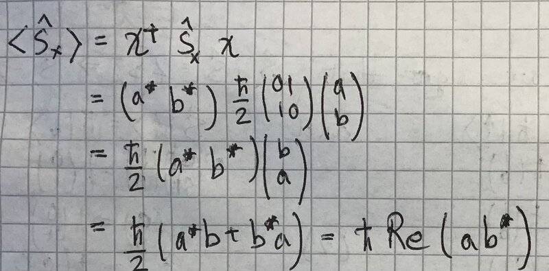

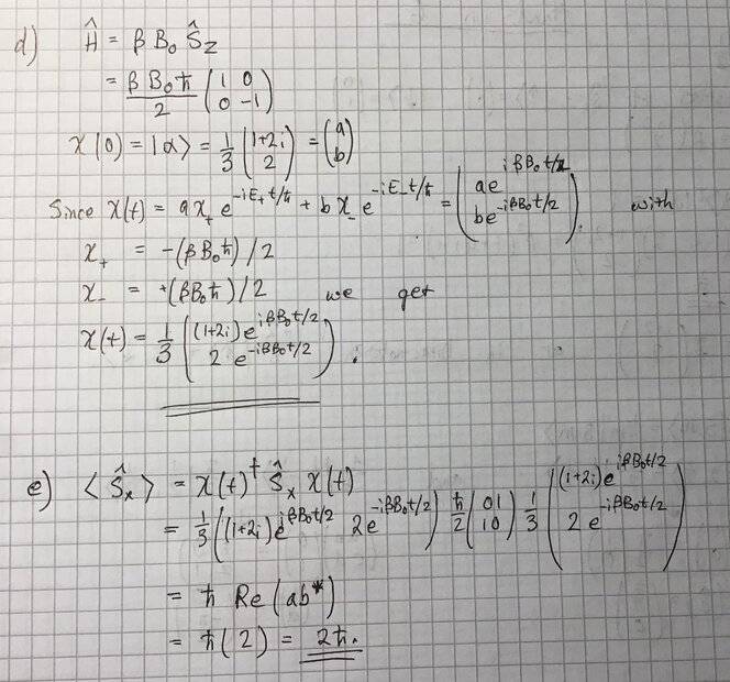

Problem e). See picture
See picture
I have found an answer to all of them (a-e) but I don’t know how to plot the function.
Thanks!

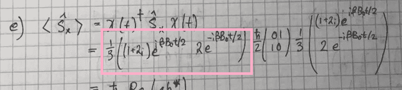

It looks like you forgot to take the complex conjugate when writing down the adjoint.

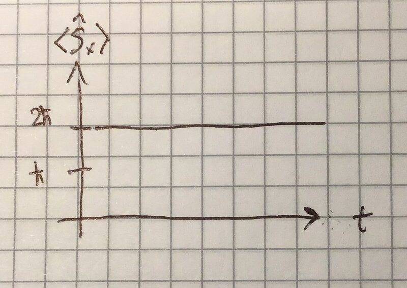

But in any case, are you really asking how to plot a constant as a function of time?
Aha ! Like this?
Yes, if your original answer is correct, but like I said, I think you didn't calculate the adjoint correctly.
Also, doesn't ##2\hbar## seem awfully big for a spin-1/2 particle?

I can second that this is wrong
you need to take the complex conjugate here
Remember that the ##\dagger## (hermitian conjugate) in linear algebra means transpose ##T## and complex conjugate ##*##, i.e.
a matrix ##A## when you do the hermitian conjugate, you do this ##A^\dagger =( A^*)^T##

🤔 Aren't you suspicious that the expectation value of spin in the x-direction is constant in a z-direction magnetic field?
Do you know the motion of a classical "rotating" charged particle in this situation? The correct solution is (perhaps surprisingly) similar.

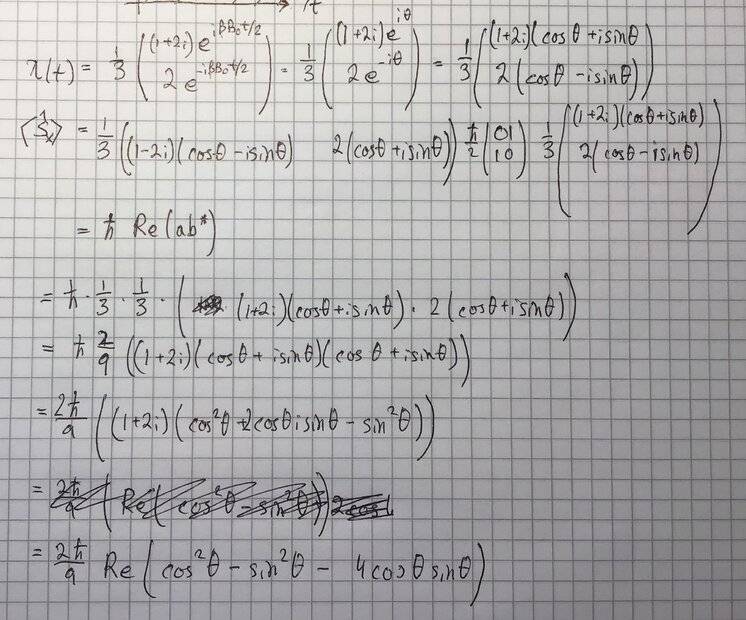

Also,the Hamiltonian drives the time evolution of the system. You should expect something to change over time in this case.
Graham87 said:
Aha, thanks. I get after correction ##(2/3)\hbar##.
Still not correct.
Could you show how you did that calculation so maybe we can spot another error?
malawi_glenn said:
Still not correct.
I used Euler formula to convert e, but I get something messy. Might my d-answer be wrong too (see pic at beginning) ?
That looks right, although if you had used the exponential form you would see that is equal to:
$$\frac{2\hbar}{9}\big (\cos(2\theta) - 2\sin(2\theta)\big )$$And note that ##\theta## is a function of ##t## here.
Ah! I got the same now. Big thanks !
