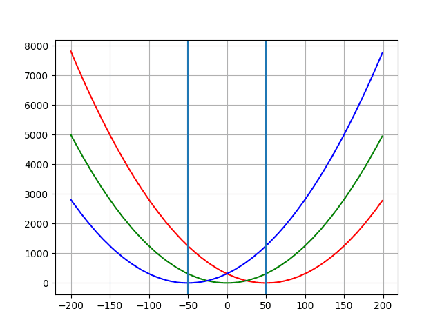

and it gives that :
i was just trying to see the effect of basic periodic function like the sin , but there is no gaps! ,
i must be missing something or doing something wrong ?
any help will be appreciated , thanks

Your model doesn't properly provide for how the periodicity of the lattice effects the electron wave function. Try studying the Kronig-Penny model, for example here, Electron in periodic lattice.
i don't understand what you mean ? do you mean that the potential function that i picked will not give arise
to a band gap at the zone bounders , ( is it must be a square wave like the Kronig-Penny model ?!)

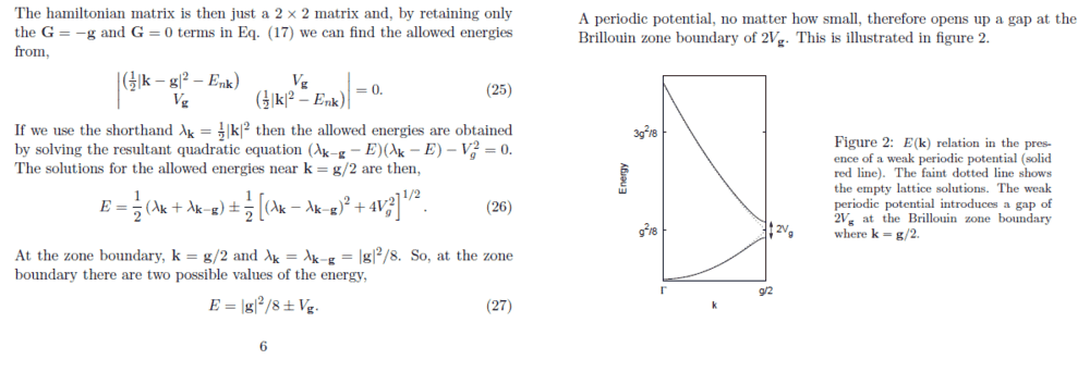

my solution was taken from this book :
how would i modify this code to show the band gap at the zone boundaries ?
In the link I provided the following dispersion relation is derived,$$
\cos (ka)=\cosh (\alpha a)+P\frac{\sinh (\alpha a)}{\alpha a}\\
\alpha^2 =\frac{2m| E |}{\hbar^2}\\
P=\frac{mV_0 ba}{\hbar^2}$$where ##a## is the lattice constant, ##b## is the width of the well, and ##V_0## is the depth of the well. Your algorithm must pick an E value for the r.h.s. of the equation, then take the arccosine and divide by ##a## to determine the corresponding k. It's a two step process, choose ##E## then compute ##k##.

thanks for helping , but i have a question :
why the paper from the book that i provided doesn't mention this , i mean the book just says
$$ E=\frac{ħ^2q^2}{ 2m} \pm Vg $$
why the book didn't mention the kronig model , does the book has another approach or it was just being
very hand wavy about it ?!
I don't have your book so I can't answer your question. I suspect that the chapter you are studying introduces Bloch's theorem but stops short of deriving a dispersion relation for a particular model...maybe in a subsequent chapter it will.
