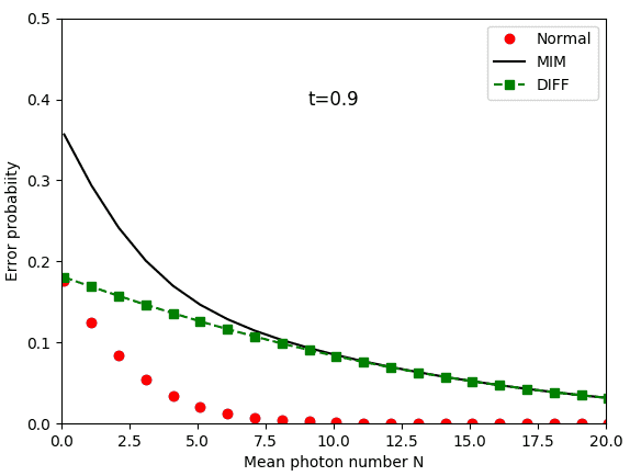

The graph produce from my code is:
Line plot of error probability against N from 0 to 20 with t=0.9: Normal (blue) falls quickly toward zero; MIM (red) and DIFF (green) start near 0.18 and 0.36 and decline slowly, converging near 0.03 at N=20.
It looks like that my plot is not same with the original one in terms N=0 of Pe^MIM (red line) and differences between two error probabilities (green line). The problem is the calculation for error probability under MIM attack was not given.

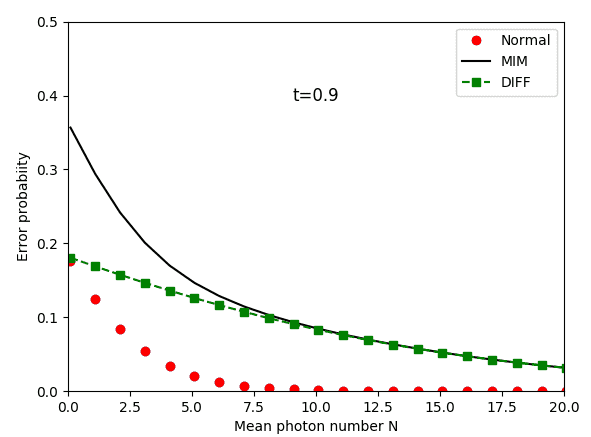

I have tried it. However, it shows the same graph that I have been plotted before.
Line and marker plot of error probability against mean photon number N from 0 to 20, with t=0.9. Solid black line MIM, dashed green squares DIFF, and red dots Normal, all decreasing with N.
  • Line and marker plot of error probability against mean photon number N from 0 to 20, with t=0.9. Solid black line MIM, dashed green squares DIFF, and red dots Normal, all decreasing with N.
