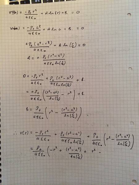

However when I try and apply the boundary conditions ie V(a)=V(r)=0... I can't get the answer!
Handwritten derivation on squared paper solving for the potential V(r) in a cylinder, applying boundary conditions V(a) = V(r) = 0 to find constants A and B and arriving at a final expression for V(r) with terms involving rho, r, a, epsilon and ln(r/a).
And for the last part I need to use Gauss's Law in integral form. Any help on where I am going wrong?
What happened to part (d)? I guess they want you to use your V(r) rather than the easy (Gaussian surface) way.
parts a and b are correct. Nicely done in fact.
In part c you have your A and B as functions of r. They are supposed to be constants. Why don't you solve for A and B using the general solution you derived in (b)? How did you come by the 3rd equation on your second sheet?
