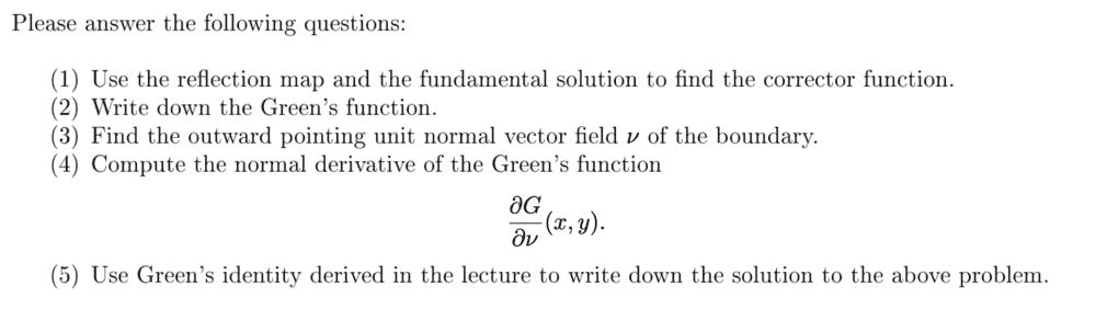

Hi all, thanks in advance for any constructive feedback. :bow:
Typeset page titled '3. Derivation: Poisson's formula for the half-space (12 points)' stating the Dirichlet problem -Δu = f in the open half-space with u = g on the boundary, and the corrector problem for φ^x with Φ(y − x) boundary data.
Typeset list of five questions: (1) use the reflection map and fundamental solution to find the corrector function; (2) write down the Green's function; (3) find the outward unit normal v of the boundary; (4) compute the normal derivative dG/dv(x,y); (5) use Green's identity to write the solution.
Definition:
If ##x\in R^n\backslash \{0\}## then the map ##\Lambda## takes the point ##x## into ##\bar{x}\in R^n\backslash R^+_3## given by ##\bar{x}=\{x_1,x_2,-x_3\}##
We take the reflected point ##\bar{x}## and the fundamental solution
$$\Phi=\frac{1}{4\pi ||x||}$$ then
$$\phi^x(y)=\frac{1}{4\pi ||y-\bar{x}||}$$
and hence $$G(x,y)=\frac{1}{4\pi ||y-x||}-\frac{1}{4\pi ||y-\bar{x}||}$$ is the green's function for ##R^+_3##
The outward pointing unit normal vector field on the boundary is given by a function ##\nu## that assigns a unit vector ##-\vec{e}_3## to every point on ##x_3=0##.
The differential operator $$\frac{\partial}{\partial \nu}\rightarrow\frac{-\partial }{\partial x_3}$$
The derivative of ##G(x,y)## in the direction of the vector field ##\nu## is given by
$$\frac{\partial }{\partial \nu}G(x,y)= \frac{-\partial }{\partial x_3}\Big[\Phi (y-x)-\Phi(y-\bar{x})\Big]=\frac{-\partial }{\partial x_3}\Big[\frac{1}{4\pi ||y-x||}-\frac{1}{4\pi ||y-\bar{x}||}\Big]$$
Have I made mistakes so far, and can I continue working?

Definition:
If ##x\in R^n\backslash \{0\}##, then the map $$\Lambda(x_1,x_2,x_3)=(x_1,x_2,-x_3)$$ takes every point ##x## into ##\bar{x}=\{x_1,x_2,-x_3\}\in R^n\backslash R^3_+##
To solve the problem
\begin{cases}
& \Delta u=f \quad \text{in} \quad R^3_+\\
& u= g \quad \text{on} \quad \partial R^3_+
\end{cases}
We consider the reflected point ##\bar{x}## and the fundamental solution ##\Phi=\frac{1}{4\pi ||x||}##. The following problem
\begin{cases}
& \Delta \phi^x=0 \quad \text{in} \quad R^3_+\\
& \phi^x(y)= \Phi(y-x) \quad \text{on} \quad \partial R^3_+
\end{cases}
gives the corrector function
and hence the green's function is $$G(x,y)=\frac{1}{4\pi ||y-x||}-\frac{1}{4\pi ||y-\bar{x}||}$$
The outward-pointing unit normal vector field on the set ##\{x_3=0\}## is given by a function ##\nu## that assigns the unit vector ##-\vec{e}_3## to every point on the set ##\{x_3=0\}##. Let us take the differential operator $$\frac{\partial}{\partial \nu}\Rightarrow\frac{\partial }{\partial (-\vec{e}_3)}$$
and compute the derivative of ##G(x,y)## in the direction ##\nu## on the set ##\{x_3=0\}## in the flat Euclidean connection
$$\frac{\partial }{\partial (-\vec{e}_3)}G(x,y)\Rightarrow \frac{1}{4\pi}\frac{\partial }{\partial (-\vec{e}_3)}\Big[\frac{1}{ ||y-x||}-\frac{1}{||y-\bar{x}||}\Big]$$
