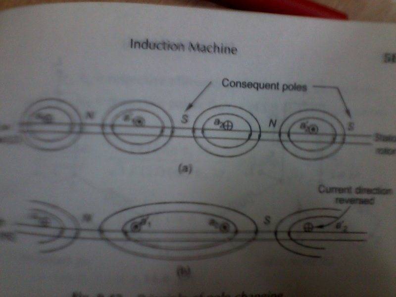

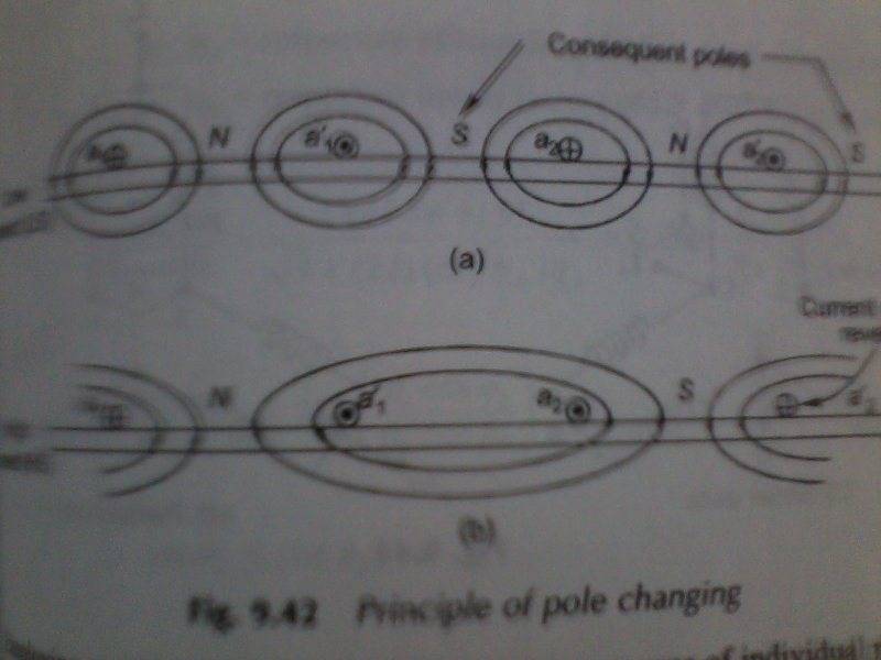

I was going through pole changing methods , when I was studying this given figure , I am quite confused in it.. in the text a1a1' & a2a2' are considered as 2 separate coils & it is assumed that both coils are carrying clockwise current , then what that "dot" & "cross" denoting?? Is it the magnetic field according to right hand thumb rule..?? But then why in a1' & a2' the direction is outwards.. as according to right hand rule it'll be inside the plane only ..!

You should read the diagrams in the context of the accompanying text. What does it say?
I think you'll find that a2 and a2' are two parts of the same loop of wire. The dot and cross indicate the direction of the current in the wire.
But I cannot see the circulation arrows properly to verify.
In the context it is assumed that current is circulating in clockwise direction in both the coils a1a1' & a2a2' . dot & cross can't denote current then , it must be the field.>!
