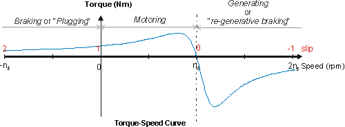

What will happen if the rotor is made to rotate at double the synchronous speed i.e slip becomes less than -1. I have never seen any diagram showing torque slip curve with slip less than -1.

But there is not much mention of the part of the curve in generating mode with rotor speed above double the synchronous speed. will there be any breaking action in that part. How will the machine behave??
Torque-speed curve of an induction machine plotted with torque in Nm on the vertical axis and speed in rpm on the horizontal axis, marking braking or plugging, motoring, and generating or re-generative braking regions around synchronous speed ns, with slip values from 2 to -1.

As the folks above say, the speed-torque curve is pretty much symmetric about synchronous speed.

Why the portion of curve with speed above twice the synchronous speed not been shown in generating action?
Will there be something similar to braking that will take place here as this part of the curve is mirror image of that part.

The case they considered was reversing the applied field while rotor is still spinning from motor's having been recently being run forward.. Same thing i proposed, throw the reversing switch while it's running...
For that case you couldn't get slip>2.
Look at the formula they derived
Equation for electromagnetic torque T_e equal to K_t over the quantity (R_e + r2/s) squared plus (x2 + X_e) squared, multiplied by r2/s.
I don't see slip limited to 2.
Torque continues to fall off because rotor frequency continues to increase , so rotor reactance x2 still limits rotor current.

But I want to ask about generating mode. Will there be some action similar to braking action in slip between -1 to -2 as this part of the curve is mirror image of the part with slip between 1 to 2 (braking action). Probably nothing should happen as such.
I also want to know that can we take the slip to any negative value say -3 or even -4 (theoretically) as we can make the rotor to rotate at 4 to 5 times the synchronous speed in direction of the rotating magnetic field.

It might be helpful to imagine yourself very small and riding on the surface of the rotor with a magnetometer.
Torque reverses when slip changes sign. That's the RPM where your magnetometer would show flux reversing its direction of apparent motion, ie North ceases to overtake you and you commence to overtake North, passing it once per slip cycle.
The only place where slip changes sign is at zero slip, ie synchronous speed.
So torque ought to asymptotically approach zero. Well, discounting friction and windage. Make that electromagnetic torque .
