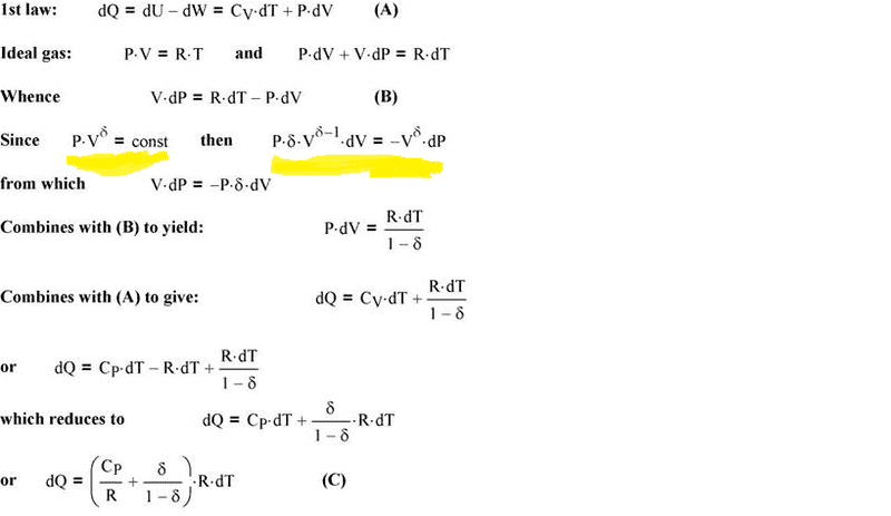

One mole of an ideal gas is reversibly compressed from 1 bar to P2
bar that results in temperature increase from 400 K to 950 K. Calculate the heat
transferred during the process and the final pressure, if the path followed by the gas can
be given by PV1.55 = , and the molar heat capacity of the gas is given by
Cp/R = 3.85 + 0.57×10-3T (where T is in K)
dU=dQ+dW
my attempt at a solution.
1. I used the first law of thermodynamics to get
dU=dQ+dW
solving for dQ
dQ=dU-dW ===> dQ=CvdT+PdV
2. Using Ideal gas solved for T then differentiated
RdT=PdV +VdP
3. It was given that PV1.55=Constant
I know since it is a real number I can use steps of a polytropic process
PVδ=Constant
This is where I am getting hung up. My books steps to solution say that using
RdT=PdV +VdP
solving for PdV
is the next step to solve the above expression PVδ=Constant.
It then says that PδVδ-1dV=-VδdP from which VdP=-PδdV
My question is how did they derive that expression from the PVδ=Constant
the end result being that
PdV=RdT/(1-δ)
Any and all help clarifying this for me would be greatly appreciated I have other formula that are all plug and chug but I would rather understand the steps involved in solving the problem with these constants.
Best Regards,
D

What do you mean by "solve the above expression"? Solve it for what?
Hint: Consider the multivariable function ##f(p,V) = \text{constant}##. If you differentiate it, you get
$$df = \frac{\partial f}{\partial p}dP + \frac{\partial f}{\partial V}dV = 0.$$
I am trying to use that PVδ=constant
The book uses that to get the term of work into a term where the n factor can be used.
Here is a picture of part of the solution I am referring to and it has the part in question highlighted
My question is how are they coming to that answer for work from that expression? Is it from your hint?

This is what I was looking for thank you!
