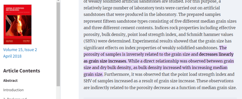

My professor said "the porosity of samples is inversely related to the grain size and decreases linearly as grain size increases"?
I've tried to figure it out considering a 2D case with a square area and in it circular grains of different sizes but the free space (porosity) happens to be the same... (Attached picture).
I'm feeling stupid but I can't understand this concept clearly

academic.oup.com/jge/article/15/2/613/5078500
That looks to be talking about sandstone. Metals have grains too, but are generally not porous...

I'm still not able to figure out why the porosity of samples is inversely related to the grain size and decreases linearly as grain size increases. I've tried to make simple examples to have a feeling but it didn't work...

here, however, we are mainly talking about water movement in relation to compaction, not porosity, and there are different grain sizes, we don't see here why the porosity decreases as grain size increases
Hmm, the text you posted says that bulk density increases with grain size, which would seem to lead to the decreased porosity, but I don't see that bulk density increase with grain size geomtrically. Have you found anything else that says this?

I looked a little more at that article you posted, and it looks like it depends on a lot of things. Have you read the whole article and followed some of the links?
Theoretically porosity is independent of median grain size. This ideal situation, which corresponds to a maximum degree of sorting, rarely occurs in nature. Several investigators have presented that well sorted naturally deposited sand grains affect porosity values. Pryor (1973) analyzed several sands and illustrated that porosity decreased with increasing median grain size. Bell (2016) stated that porosity ranges from 44%–49%, 41%–48% and 39%–41% for fine, medium and coarse sands respectively. Al-Homadhi and Hamada (2001) reported that as grain size is increased, porosity decreases slightly. This behavior is seen in the three class of cementation. Ogolo et al (2015) studied the moderately sorted and well sorted sands obtained from three different locations in the Niger Delta and indicated that porosity decreases with increasing grain size. They generally observed that porosity decreased from about 42% to 26% as the sand grain size increased from 45 to 1000 μs. However, in contrast with these findings, Brown (1993) illustrated that, in carbonate rocks, as grain size increases, porosity increases. He noted that this relation of porosity to grain size is usually seen in petrographic studies on detrital rocks. Also, Ulusay et al (1994), working with sandstones, indicated that the relationship between effective porosity and grain size is statistically significant and there is a tendency for porosity to increase with median grain size.

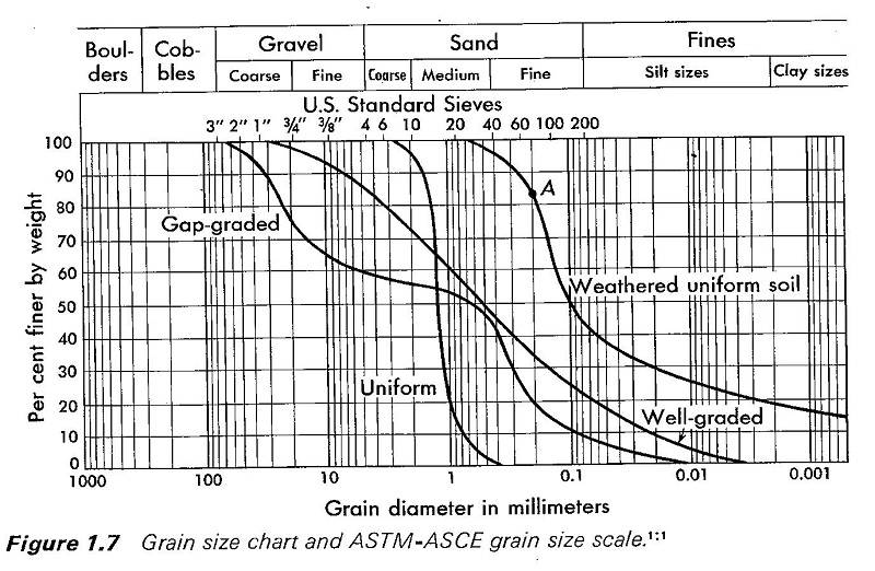

Sand of "uniform" particle size has a wide range of particle sizes. This figure, from Introductory Soil Mechanics and Foundations, 3rd Edition, by Sowers and Sowers shows a typical range of particle sizes for a uniform graded sand:
The particle sizes in uniform graded sand range in size by almost a full order of magnitude. While most of the particles have a small range of sizes, the resulting porosity will differ from a porosity calculated using spheres. And it is easy to believe that the particle size distribution will vary with median particle size, which would explain the data in Posts 3 and 11.
