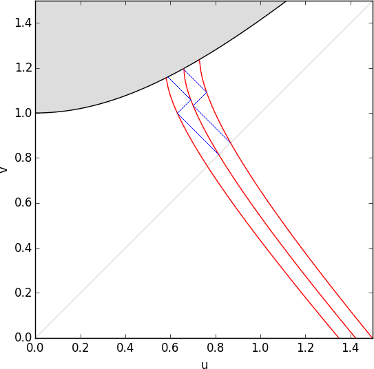

PeterDonis said:
It is perfectly possible for objects inside the horizon to exchange light signals.
How so?
alantheastronomer said:
How so?
You can see it's possible from a Kruskal diagram. It obeys the same rules as a Minkowski diagram - light travels on 45° lines and timelike paths are above 45°. There's a fairly narrow window for communication between horizon and singularity, but it can happen. And one way communication is always possible, at least in principle.
It's also obvious from the locally Minkowski nature of spacetime. If we are close enough together then we see spacetime between us as flat, so obviously we can communicate. That can't cut off dead outside "local" distances unless something catastrophic (like the singularity) happens to one partner.
A practical example. Suppose you are on the stern of a somewhat long spaceship, and you're looking at an object in the bow of the spaceship. While you are looking, the front of the space-ship crosses the event horizon of a very large black hole. You snap snapshots just before, at the same time, and just after the front of the spaceship crosses the event horizon of a very large black hole. The black hole is so large that the curvature at the event horizon is negligible.
What do the photos show?
In all three cases, the photos show the object as normal, as if the black hole were not present. The assumptions we made that the black hole is large enough that curvature / tidal effects can be ignored is important for this result to be correct.
For completeness, I should add an explanation of what I mean by "at the same time". Due to the fact that space-time curvature can be neglected, there is essentially a local inertial frame of reference for the space-ship. It is in this local inertial frame that we judge the idea of "at the same time", via the usual convetions we apply to an inertial frame in Special relativity. You might be familiar with the Schwarzschild time coordinate "t". We are NOT using that time coordinate to judge "at the same time", we are using the notion of time associated with the local inertial frame of the ship. Due to the relativity of simultaneity, we need to specify a particular inertial frame to define the particular notion of simultaneity we are using.
To be specific, consider the photograph taken after the bow of the ship falls through the horizon. The r-coordinate of the light is decreasing with time, but slowly. The r-coordiate of the back of the ship is increasing more quickly. At some point, the light ray from the front of the ship hits the back of the ship. This will only happen after the stern of the ship has crossed the event horizon. But it is an example of "objects inside the horizon to exchange light signals."
Technically, we've only analyzed one signal of the two-way exchange. But the analysis is similar for the case of an exchange of signals in the other direction.,
You seem to mean 'is decreasing more quickly', right?
And is it correct that this happens in the moment the stern is crossing the event horizon as this light ray is "frozen" at ##r=2m## because it was emitted in the moment the bow was crossing the event horizon?
Oops, yes.
I had three cases in the original - just before, just at, and just after the crossing. For the middle case, yes, the r-coordinate of the light signal emitted from the bow as it crosses the stern hangs there, and it is actually photographed when the camera reaches the horizon.
