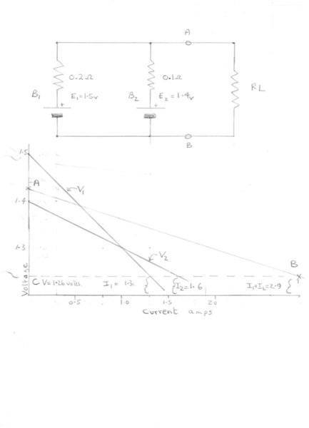

I don't have time right now, but I will post a diagram about parallel generators or batteries, you might find interesting and worth leading the better students towards
OK here we are.
We have a nominal 1.5 volt battery, B2 that is somewhat discharged to 1.4 volts and we wish to boost its performance by adding a smaller, but fresh, 1.5 cell, B1. The diffrence in battery size is reflected in the different internal series resistances shown.
Now consider first each battery separately (that is without the other in circuit). As the current drawn by RL increases the terminal voltage seen at AB by the load drops.
For battery B1 it is 1.5volts at zero amps and drops at 0.2 volts per amp. This is shown as line V1 in the diagram.
For battery B2 it is 1.4volts at zero amps and drops at 0.1 volts per amp. This is shown as line V2 in the diagram.
To obtain the load sharing for any given combined terminal voltage,
Draw a line parallel to the current axis ( I have shown 1.26 volts dashed) at the required terminal voltage.
Read off the intercepts I1 & I2 this will give the total load current = I1 + I2.
This gives point B on the graph.
To plot point A
Note that at zero load current there is (1.5 -1.4)/0.3 amps circulating between the batteries.
The combined terminal voltage is given by either the EMF of B1 minus this current time O.2 ohms or the EMF of battery B2 plus this current times 0.1 (ohms). that is 1.4333 volts.
Thus by joining points A and B you have plotted combined terminal voltage against load current.
Those with lots of times and better computer graphics resources than I possesses are welcome to construct a prettier diagram. Any copyright is waived, you are welcome to use this information in for teaching purposes.
I didn't get this point. Could you explain it ?
Best Regards,
DaTario
When the load is disconnected (RL=[tex]\infty[/tex]) there is only the loop containing the two batteries and their series resistance.
Since in this loop the batteries are connected in opposition, the emf in the loop equals the difference of their EMFs ie 1.5 - 1.4 = 0.1 volts.
This EMF drives a current through the total loop resistance of (0.2 + 0.1 = 0.3) ohms.
By Ohm's law this current therefore equals 0.1/0.3 = 0.3333 amps.
If you prefer the 0.1 volts EMF in the loop is divided between the two series resistances in proportion to their values, as with any voltage divider. That is 2/3 across the 0.2 ohms and 1/3 across the 0.1 ohms.
Remember what we are talking about is the terminal voltage as seen by the outside world (ie the load resistor).
Terminal voltage = Battery EMF (which does not alter) minus the voltage drop across the internal series resistance (which depends on current drawn).
What I am showing is the effect on terminal voltage of combining two (or more) batteries in parallel.
