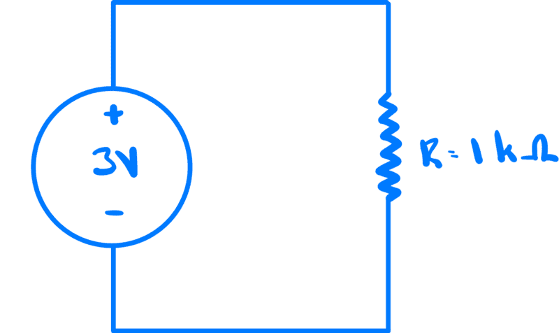

Consider the following circuit

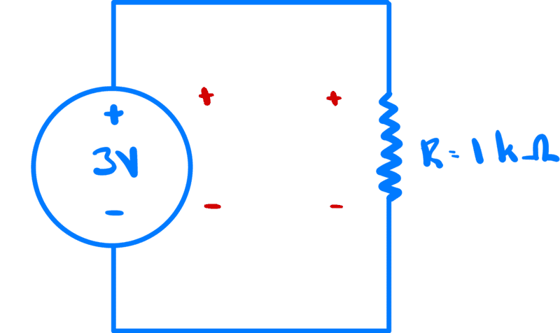

The first thing we do is to label each terminal of each circuit element. We use the labels + and -.
We could assign these differently (and I will do this in a second example further below), but for now let's stick with these labels.

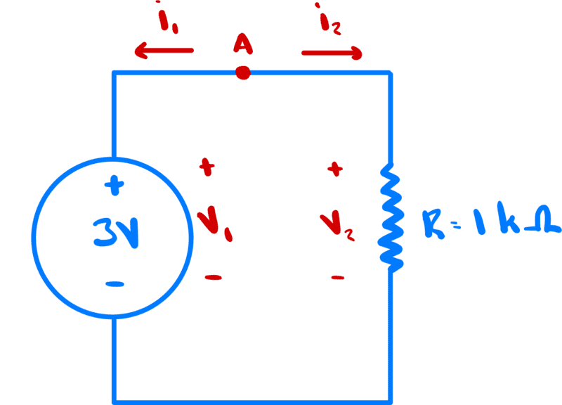

Next, we assign terminal variables. For each circuit element, we have a current going into the positive label. We also have a variable for each circuit element denoting the difference in potential between the + terminal and the - terminal.
Since our choice of voltage terminal labelling coincides with the battery's actual positive and negative terminals, we immediately know that ##v_1=3\text{V}## and with KVL we can show that ##v_1=v_2=3\text{V}##.
With KCL we can see that ##-i_1-i_2=0## so ##i_1=-i_2##
Given ##R## we know that ##i_2=\frac{v_2}{R}=3\cdot10^{-3}\text{A}##.
Thus, ##i_1=-3\cdot10^{-3}\text{A}##.

The convention is to calculate power by multiplying the current variable into the positively labeled terminal by the voltage terminal.
Thus, we have that "power into the battery" is
$$i_1v_1=-3\cdot10^{-3}\text{A}\cdot 3\text{V}=-9\cdot10^{-3} \text{W}$$
and "power into the resistor" is
$$i_2v_2=3\cdot10^{-3}\text{A}\cdot 3\text{V}=9\cdot10^{-3} \text{W}$$

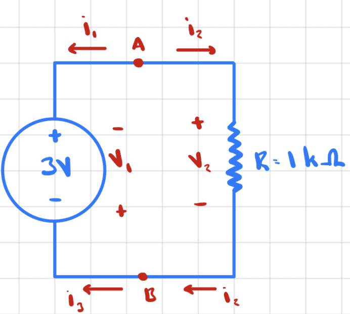

For example, consider the following change in the terminal voltage variables of the battery
##i_3## turns out to be the negative of ##i_1## and is the current going into the positive terminal voltage on the battery. Recall that previously, the incoming current was ##i_1##.
However, the diference in potential (which is the potential at the positive terminal minus at the negative terminal) is actually the potential at the battery's negative potential minus the battery's positive potential. Previously, it was the opposite (battery's positive potential minus battery's negative potential), so this also changed signs).
Therefore, when we calculate the power into the battery, the result is the same as before
$$i_3v_1=(-i_1)\cdot(v_1^+-v_1^-)=-i_1\cdot (-3)=3i_1<0$$
