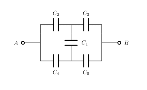

Hi, the solution of my exercise says that the potential difference in the capacitor C1 is zero.
Circuit schematic of five capacitors between terminals A and B: C2 and C4 on the left arm, C3 and C5 on the right arm, and C1 as a bridge across the centre joining the two middle nodes.
Can you please explain me why it's the case ?
Thank you.
You don't have any values for those capacitors. This is an example of a bridge circuit. Read this article for some insight. https://en.wikipedia.org/wiki/Bridge_circuit
Resistors and capacitors work differently, but be assured that there are capacitor values which would result in the voltage at the top of the C1 to be the same voltage as the bottom of C1. For example, if we have 10.5 volts at the top and 10.5 volts at the bottom, then 10.5-10.5 = 0.
Owwww I'm sorry, I forgot to give the values !
In fact, we have C2=C4 = 1.0μF and C3=C5 = 2.0μF.
However what if, in this case, we have C2 =/= C4 OR C3 =/=C5, C1 wouldn't be equal to zero anymore, right ?

Correct.

You should really take a look at the article on Bridge circuits, which I pointed to in the earlier post. Once you understand how resistor bridge circuits work, it will not be much of a stretch to understand other components, such as capacitors.
