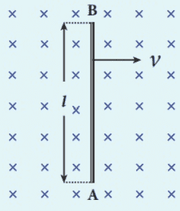

I understand about motional emf:
Diagram of a vertical conducting rod AB of length l in a uniform magnetic field into the page (crosses), moving to the right with velocity v.
Using Fleming left hand rule, the force acting on electrons in the rod will be downwards so point B will be at higher potential to point A and there is emf between A and B. The formula of the emf is Blv and I also understand how to derive the formula

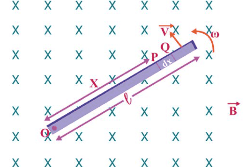

I also understand about rotating rod in magnetic field:
Diagram of a conducting rod in a uniform magnetic field into the page (crosses), rotating with angular velocity omega about end O, with velocity V shown at point Q, length l, and labeled points O, P, and Q with distance x along the rod.
The force acting on electrons in the rod will be towards point Q so point O will be at higher potential and there is emf between O and Q. The formula is ##\frac{1}{2}Bl^2 \omega## and I also understand how to derive that.

@songoku, see if this helps.
In Post #7 you have a rod moving to the right with velocity v. The upper end will become positive and the lower end negative.
This is true for any shape conductor moving to the right. Don’t let the shape/topology of the ring distract/confuse you. It's just a moving conductor.
The top of the ring (point A) becomes positive and the bottom of the ring (point O) becomes negative, just like the rod.
If it helps, consider the ring as consisting of two semi-circles (left and right halves of the ring). Each semi-circle is just a bent rod.
Question: Suppose the top of the ring is +5V and the bottom is -5V. Would current flow clockwise or anticlockwise round the ring?
Answer: The ring is acting as a cell (positive terminal A, negative terminal O) which just happens to have an internal circular construction. There is no current around the ring because the ring is not acting as a circuit here.

I think it is the same as deriving formula for rotating rod in magnetic field in post #7

Assume the half ring OA doesn't rotate. It just slides to the right at some speed ##v##.
The assumption of a constant and uniform magnetic field means there is a well defined electric potential field ##V(\mathbf{r})##. For an arbitrarily moving conductor, ##\mathbf{E} + \mathbf{v} \times \mathbf{B} = 0## (recall: if ##\mathbf{v} = 0##, then the familiar ##\mathbf{E} = 0## for stationary conductors is recovered). Parameterise one half of the ring, ##OA##, by the angle ##\theta## from the downward vertical at some instant. Write for the velocity of each point on this part of the ring,\begin{align*}
