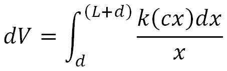

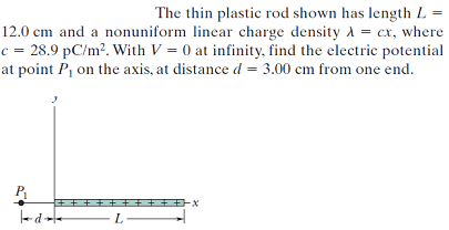

V=kq/x​
I know the correct solution. It's...​
On my first attempt, rather than use (d+x) in the denominator and integrate from 0 to L, I instead used (x) and integrated from (d) to (L+d).
This produces the wrong answer, but why does it produce the wrong answer? Both approaches seem to capture the setup and handle the integration correctly. Obviously I'm wrong, but - again - why/how am I wrong? Thank you.

##\lambda## is no longer ##cdx## if you change variables. You can avoid this kind of oversight by using a different integration variable name, e.g. ##u ## or ##v##, but not the same name ##x##
Thank you! However, question: where did I "change variables" and/or why is λ no longer cdx?
You changed the integration variable ##x## that runs from 0 to L into a variable with name e.g. ##u## that runs from d to d + L. In other words ##u = x+d##. When ##x = 0##, ##\lambda = cx=0##, but when ##u=d##, then ##\lambda \ne cu##.
Ah, thank you so much. This is very helpful. I appreciate your explanation very much!
