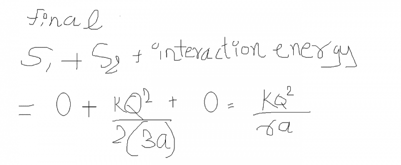

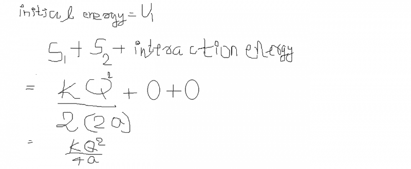

A solid conducting sphere of radius a having a charge Q is surrounded by a conducting shell of inner radius 2a and outer radius 3a as shown.Find the amount of heat produced when switch is closed.
Heat produced=Initial energy -final energy
I have taken interaction energy to be zero on the basis of the answer of OP.And I have considered formula of self energy of conducting and and non conducting spheres to be same.
I know formula of self energy of conducting sphere is ##\frac{KQ^2}{2R}##
Heat produced=##\frac{KQ^2}{4a}## - ##\frac{KQ^2}{6a}##
= ##\frac{KQ^2}{12a}##
But it is wrong!

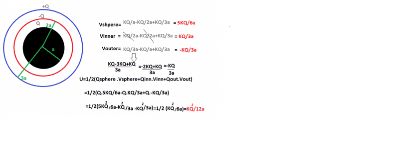

What kind of changes shall I make in my calculations now?I don't know what is self energy of shells having significant thickness and I also don't know how to calculate interaction energy in such situation.
If you have a system of static charges where an amount of charge Q1 is located where the potential is V1, an amount of charge Q2 is located where the potential is V2, and an amount of charge Q3 is located where the potential is V3, then the total potential energy of the system is
U = (1/2) (Q1V1 + Q2V2 + Q3V3)
This is a generalization of the formula for the potential energy of a capacitor: U = (1/2)QV.
Try to apply this to your system where you have three charges: charge on the sphere, charge on the inner surface of the shell, and charge on the outer surface of the shell.
U = (1/2) (QsphereVsphere + QinnerVinner + QouterVouter)
You should find that the last two terms simplify nicely. The work will be in getting the first term.
I solved it as follows
But it is not correct where I went wrong.
Why are the potentials at the surfaces of the outer shell different ?
I calculated it. Just the sign is opposite.
You did not show your calculation. The outer shell is a conductor. What do you know about the distribution of potential on a conductor?
That it is same everywhere inside the conductor.
Is it different on the surfaces of the conductor?
ehild said:
Is it different on the surface of the conductor?
No.
gracy said:
No.
Then your calculation is wrong if you got different potentials for the inner and outer surfaces of the same conductive shell.
Yes but what is wrong in my calculation that I want to know.
You can not calculate the potential so.
I did not understand .potential of what?
The potential of what have you calculated?
I have calculates potential of the inner sphere and potentials of inner and outer surfaces of the outer shell.
Why is the potential of the outer surface of the outer shell -kQ/(3a)?
I have calculated (my post #19)could you please tell me what is wrong in there?
Explain the terms in Vouter. What are they?
