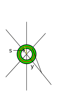

A thin disc, radius 3 cm, has a circular hole of radius 1 cm in the middle. There is a surface charge of -4 esu/##cm^2## on the disc.
a) what is the potential at the centre of the hole ?
b) An electron starting from rest at centre of the hole moves out along the axis. What is the ultimate velocity it gains ?
For (a) :
##R = \sqrt{y^2 + s^2}## and ## dq = 2\pi s\sigma ds##
I did not drew ##\theta## but it is the angle between radius vector ##r## and ##y## axis.
Then,
##\displaystyle \phi(0,y,0) = \int^3_1 {dq \over R} = \int^3_1 {2\pi \sigma s ds \over \sqrt{y^2 + s^2}} =2\pi \sigma (\sqrt{y^2 + 9} - \sqrt{y^2 + 1})##
For centre, ##\phi = 2\pi\sigma##
For (b):-
Since ##\cos \theta = \dfrac{y}{\sqrt{y^2 + s^2}}##
##\displaystyle E = \int^3_1 {dq \over R^2} \cos \theta = \int^3_1 {2\pi \sigma s y \over (y^2 + s^2)^{3/2}} ds =\sigma\left( \frac1{\sqrt{y^2 + 1}} - \frac1{\sqrt{y^2 + 9}}\right)##
##eE = ma = m y^{\prime\prime} = m v\dfrac{dv}{ dy}##
##\displaystyle {e\sigma \over m} \int_0^{\infty} \frac1{\sqrt{y^2 + 1}} - \frac1{\sqrt{y^2 + 9}} dy = \frac{v^2}{2}##
Hence ##v = \sqrt{\dfrac{2e \sigma \ln 3}{m}}##Is this correct ? I think the second answer is not correct as I get ##2.16 \times 10^{7} m/s## as the answer, which is very huge.

You dropped a factor of 2, it seems, but it otherwise looks right.
I'm not sure what this means. What ##\phi## supposed to represent?
##\displaystyle \int {s\over \sqrt(y^2 + s^2)} = \sqrt{s^2 + y^2}## ?
vela said:
I'm not sure what this means. What ##\phi ## supposed to represent?
I am sorry, this was vague.
##\phi(0,y,0)## is electrostatic potential which is ##2\pi \sigma (\sqrt{y^2 + 9} - \sqrt{y^2 + 1})##.
The question to find the potential at the centre of the disc which is at ##y =0##
So, ##\phi(0,0,0) = 2\pi \sigma (3 - 1) = 4 \pi\sigma##
You seem to be making this part unnecessarily complicated. Use conservation of energy. What's the potential energy of a charge at the center in terms of the electric potential at the center?
Let me get first part correct because I can use that to find energy.
Sorry, you were right. I messed up the factor of 2.

Buffu said:
Is everything else correct ?
I think there are some errors in the field calculations.
(It would be easier to follow if you had left the radii as variables instead of plugging in the values 1 and 3. That would have allowed the use of dimensional analysis to sanity-check the equations.)
E should be obtainable by differentiating φ wrt y. If I do that there seems to be a missing factor 2πy.
I certainly don't think you should be getting ln() terms in there when they do not turn up using the energy approach.
As for the magnitude of the answer, I think you are in the right ballpark, but maybe that means you need to use relativistic equations.

Yes you are correct.
Then ##\displaystyle E = {2\pi y \sigma}\left({1\over \sqrt{1+y^2}} - {1\over \sqrt{9 + y^2}} \right)##
and
is
##\displaystyle {e\sigma \over m} \int_0^{\infty} {2\pi y }\left({1\over \sqrt{1+y^2}} - {1\over \sqrt{9 + y^2}}\right) dy = \frac{v^2}{2}##
I got the improper integral as ##2##,
So ##\displaystyle v = \sqrt{8\pi e \sigma \over m}## which is ##7.38 \times 10^7 m/s##

That's what I got by considering energy. But that is a quarter light speed, no? Doesn't that mean you need to use the relativistic formula for KE?

I get the simplified solution as ##\displaystyle c\sqrt{4\pi e \sigma \over 4\pi e \sigma + mc^2} = v## is this correct ? Which is ##5.10 * 10^7 m/s##.
I get ##\frac{v^2}{c^2}=1-\left(\frac{mc^2}{E+mc^2}\right)^2##.
If v' is the velocity you calculated by Newtonian principles, E=mv'2/2.
But looks like it's not quite fast enough to worry about. If e.g. v' is c/4 then v≈ 0.238c
