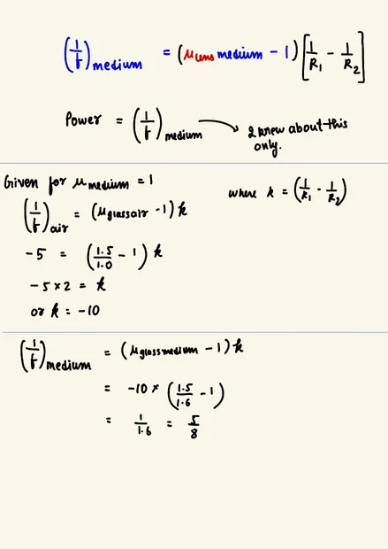

A thin glass (refractive index 1.5) lens has optical power of-5 D in air. lts opticat power in a liquid medium with refractive index 1.6 will be
P = 1/fₘ = (μₗₑₙₛ₋ₘ - 1)[ 1/R₁ - 1/R₂]
Here is what I tried
This question was actually asked in one of our engineering entrances.
The answer was 1D.
My teachers say that we have to use μₘ/fₘ to get to this answer. I cannot understand why. I'll be really glad if you could tell me the exact definition of power (numerically) that works in all scenarios.

Welcome to PF @shubhamakshit. The above formula only applies to a thin lens when the surrounding medium is air/vacuum (refractive index = 1).
The power of a lens in a medium, m, is the refractive index of the medium divided by the focal length in the medium: ##P_m = \frac {\mu_m}{f_m}##. When the medium is air/vacuum this simplifies to ##P = \frac 1f##.
The general formula is ##P_m = \frac {\mu_m}{f_m} = (\mu_{lens} - \mu_m) [\frac 1{R_1} - \frac 1{R_2}]##.
See if you can get the correct answer using that information.

Well that did give me the answer.
Thanks a lot.

I'm not sure where you got this formula from. I've referred to more than 1 book, but couldn't find your version of the formula. I've gone through the derivation of lens maker's formula, but couldn't find any reason, why the power should be defined the way you have written.
I think, the initial calculation by OP is correct. P = 5/8.

The derivation of lens maker's formula already encapsulates the condition of refractive index of medium being different from that of the material of the lens. There's no need to further include the refractive index of the medium while defining power of the lens.
