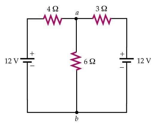

I am given the circuit, which is shown in the attachment, and I need to calculate the power supplied from each of the 12V batteries.
I have already solved for the current in each resistor and the potential difference between a and b.
The only equation I know to use is P= IV, where I am calculating I by dividing V/R(equivalence)
I have tried solving this multiple times, all without success. My most current attempt at the Power supplied from the right side was finding R(equivalence) = 9 the using I=V/R, then using the new R (4/3) in P=IV P=(4/3 A)*12V, where P=8, which I thought was a rather low number.

Use Kirchoff's law to find the amount of current flowing in each branch i.e. through each resistor. Once you've done that, use the formula:
<br /> P = I^2R<br />
to find the power dissipated.
Should I calculate the Power dissipated from each resistor in the loop then sum them to get the total power?
If you sum I^2R for all the resistances in the circuit that will give you the total power delivered by both voltage sources. But you need the power of each of them separately.
A voltage source with potential difference V that delivers a current I delivers a power VI
