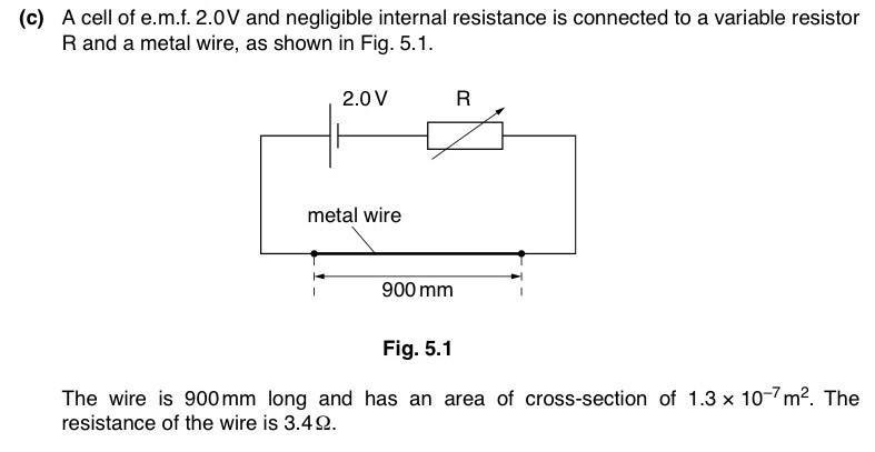

Circuit schematic: a 2.0 V cell in series with a variable resistor R, connected by wire to a metal wire 900 mm long, with the 900 mm length marked below the wire. Labels: 2.0V, R, metal wire, 900 mm, Fig. 5.1.

Janiceleong26 said:
For zero resistance, I used P=V2/R formula, and sub. R=0 , power would be infinite.
Both R and V go to zero, so you have "0/0" which is undefined. You cannot use this formula.
Oh I see.. Thanks
But if resistance is infinite, then shouldn't voltage be infinite too?
mfb said:
No. Why do you expect this?
Because V=IR, V α R, though I feel that it doesn't make sense to have an infinite voltage..
Remember we are talking about the voltage drop across Q.
V α R is only true at fixed current.
What is the current you expect for infinite resistance?
And, as cross-check, can the voltage at the resistor exceed the source voltage?
Zero current :biggrin:
Oh yeah.. Never thought of that too, thanks!
