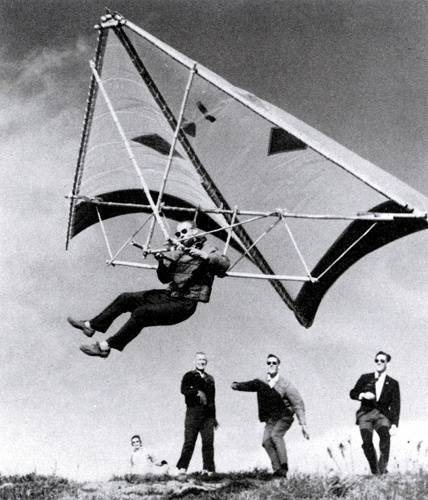

Part of the problem is that modern "manufactured product" designs are too sophisticated to build safely "by hand". Hacking away at a sheet of ripstop nylon with kitchen scissors isn't accurate enough, and hand sewing woudn't handle the high wing loadings safely.
If you want to build something from scratch, try to find a design from the 1980s or earlier. It won't win any prizes for high performance, but it will fly perfectly well within its limitations.
Like this?
Just kidding.
